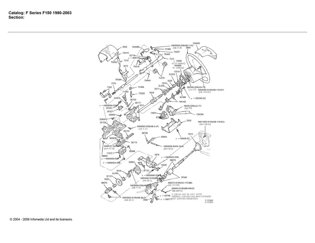

The part that breaks in the 7212 and the 7R264 also you should replace the bushings.
94 F150 parts list
1. 1F1Z7212AA
2. F7DZ7R264AA
3. F3TZ7L278A X2
