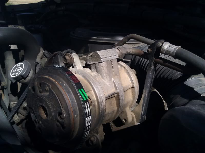

AC Compressor works... but have another question
Got a belt on the compressor today and it works pretty dang good. smilieFordlogo

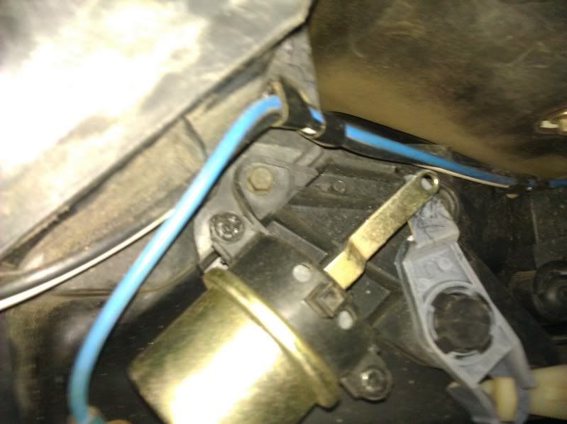

Not a vacuum problem, huh. Looks like it has something to do with the mechanical mechanisms under the dash. Look below:
The gray piece rotates to control defrost/vent/floor.. By moving it to the left, it does indeed turn on the vents, then the floor. Also note that the gold bar should be attached to the end of the gray piece. I connected it, but using the controls on the dash nothing happened. I tried manually moving the gray piece again, but the gold bar sprang back to the defrost setting.

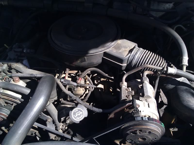

For your viewing pleasure, a rare glimpse into the stuperduty's engine compartment.
I want sooooo bad to clean it!

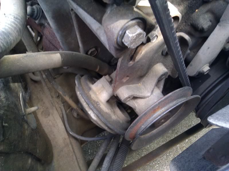

I had an epiphany today! Got to looking around the engine bay and put 2 and 2 together. The vacuum switch doesn't work properly because... drum roll... THERE'S NO BELT ON THE VACUUM PUMP!
Now I know. :D
