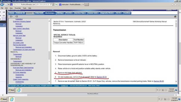

If they dont have them, then why this instruction?

Hey just to confirm, the E4OD was offered in a 2wd set up. Without question, my 1994 came bone stock from the factory with a 351w, E4OD, and is 2wd. It wasn't modified in someone's garage, it wasn't something a shop did to save a few bucks, it was built that way.
If you guys read all the posts. you will read that i said that i have a 1990 F150 2wd here that has a E4OD . it does happen. But it not the norm.
Most 2wd F150 are not E4ODs.
Its a GVW limit. At a given GVW and over the E4OD was the trans that was given. But most 2WD F150 did not fall under that GVW. But all 4WD F150 were over that GVW limit. So all 4WD truck had E4OD trans.

No Lightning were the only 2wd F150 ever made with a E4OD.
All the 4wd F150s and any F250 and F350 were all E4OD trans trucks. from mid 1992 to 1996
IDK why they did that way. I have A 1990 F150 2wd with a 302 and its got a E4OD in it.
But when you look at a 1993 2wd F150 Like Chris's truck its got a AOD under it. And any 1994 to 1996 2wd F150 has a AODE or a 4R70 in it
It never made any sense to me.
But no. your truck got a E4OD under it.

Then why make the bolded statement, and turn around and get all pissed off when others disagree? So it wasn't the norm you saw, but the fact remained that they did come that way. That then means that a statement saying "only the Lightning came with them" is false. That is what others have been trying to say.
So you know quite a bit about these trucks, and you are at mid life. So am I. You are younger by me, admittedly by only a few years, but the attitude you have that you know more and are older than others here is completely off. You know Vince, the Master tech? The one you bet you are older than? He was working on Fords well before YOU were born. So drop the attitude, present the info, which you obviously have plenty of, and we will all get along just fine. We are going to have disagreements, happens all the time, but we don't get all pissed off and publicly degrade each other. If I am wrong, prove me wrong. You lose the argument the moment you get the attitude and the put downs out. I can't argue with fact. Oh, and while books aren't the only answer, they are a useful resource. Of course there are other ways to fix a problem, they only present ONE option that the engineer writing it feels was the best. We all know that is not true. The service books are not gospel, they are a tool.
