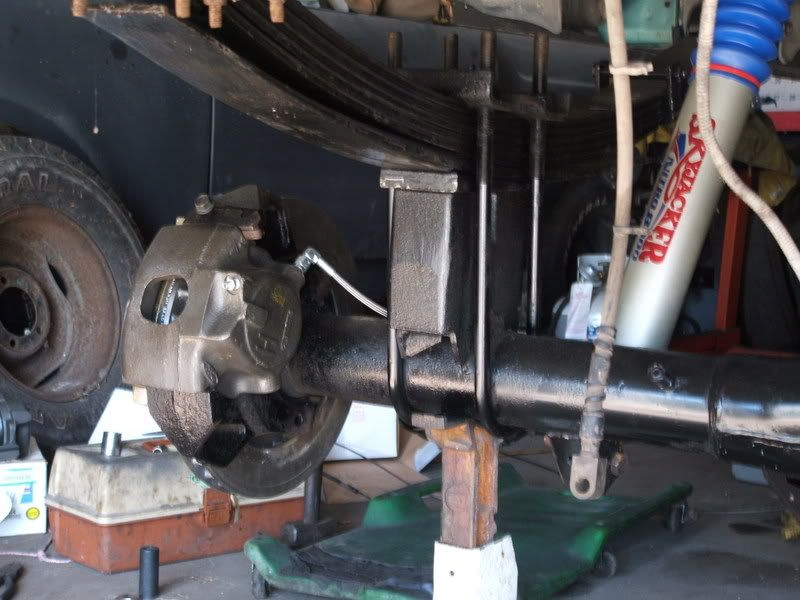

On my truck I made my own conversion using 79 4x4 front brake parts.
I unbolted the caliper mount and made a notch in it so it would slide over the rear end housing. I then made a plate that would bolt it to the bearing retainer bolts. I ground the axle flange a little so the front rotor would fit over it. I did have to get longer wheel studs.

I took the piece off of a 4x4 front axle that holds the brake caliper. It has a round hole in it that the axle goes through. I took a notch out of it so it was kinda a u shaped hole and let it slide over the rear axle tube.
I the made a plate that allowed it to bolt to the axle housing.
Sorry I didn't explain very well.
