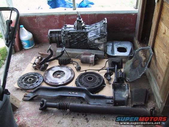

Here are all the parts needed for an auto to manual swap:

Chris I am doing a Manual to Auto Swap. That is why I asked what Auto trans came in a 88 F150.
Oh I misunderstood. Well the the needed parts should be mostly the same as that picture except switch out manual-specific parts for auto specific parts-- ie, instead of a floor shifter you need a new column with a shifter there. And of course you need to delete the entire clutch system, which requires a new ebrake pedal assembly (in gen 9's and probably 8's the clutch and ebrake pedals are all 1 assembly that comes out in 1 piece). Also a floorpan cap to cover the hole in the center hump after the shifter comes out
