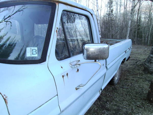

The weather around here has not been all that cooperative, but I was a little bored and we had some sun and decent temps, and the truck really needed a set of mirrors that would allow me to back it up. Getting it stuck on the side of the driveway because I couldn`t see what I was doing kind of set things in motion.

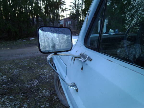

Anyways, I had some gen 7/8 mirrors in the barn, so I threw them on there. Looks mucho better, and I can see what I`m doing when I back up now.

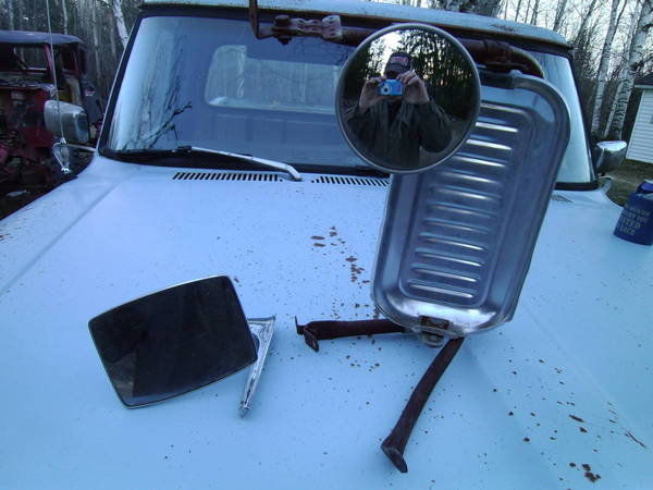

Here`s what was on there.
And now.
Those look good on there.

Not bad, huh? I put some 7x10 camper mirrors on a friends 68 one ton several years ago. Those turned out pretty nice also. 80-96 mirrors fit these trucks pretty well actually.
The price was right also.:)
Not bad at all! :beer:

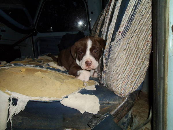

I did not take any pics of the stuff I did this morning. Thought about it. I do however have a picture of the new co-pilot. Will that do?
Yeah, the kittys are less than enthused.

The pooch looks pretty happy and relaxed!

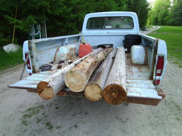

I haven`t had the time to fix the stuff that is preventing this from being a daily driver, but how about a picture of the ole girl girl hauling a BIG load of posts from the yard to the barn.

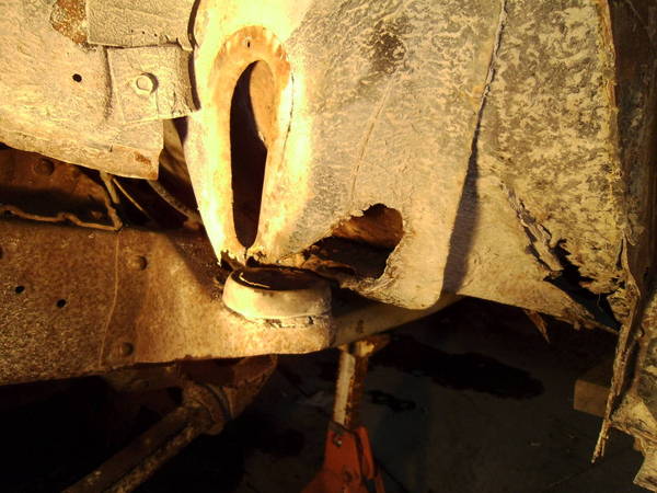

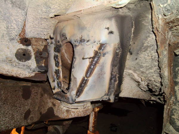

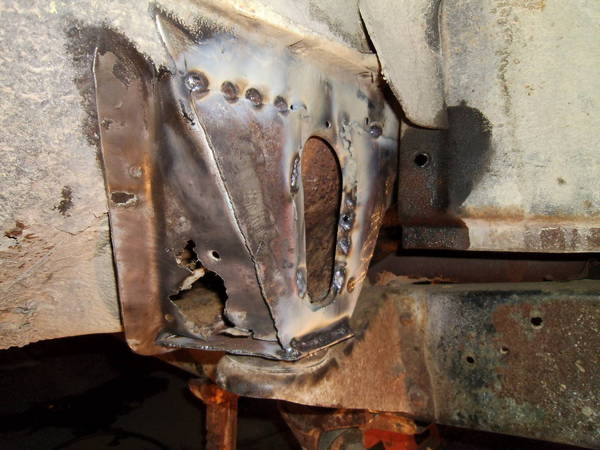

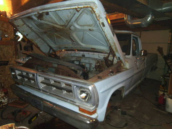

So I dug the old girl out of the snow bank last week, and got it shoved into the garage. The carb is full of crap, so it wouldn`t drive in. I was going to work on it last weekend, but I screwed up my back.
But I was able to work on it today, so I tackled the cab mounts. I patched them together with some 1/8" plate because the cab itself has enough wrong with it that I cant justify buying new.
Don`t laugh to much. I still have some work to do, like finish the passenger side, some welding, and some grinding, but at least they will hold the cab up.

Those mounts look like they will do the trick.
