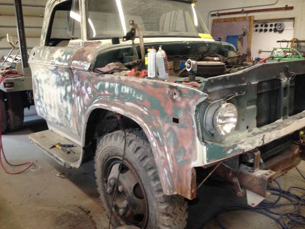

The boss was thinking we`d just putty it up and spray bomb it Rust-Oleum forest green. He messed up buy not telling the Mopar guy and the guy who likes to do stuff right and nice (me) his plan lol. We started by sanding off the TSC paint and it escaleted. Everytime he came in the shop it was torn down more lol.

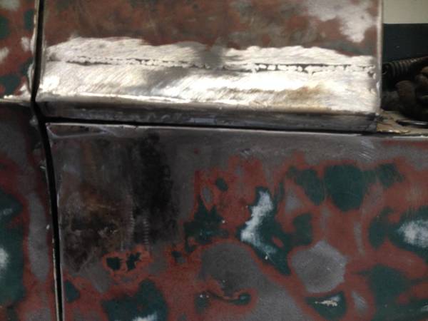

These trucks rust out on the cowl sides. I patched those. I also patched the top corners of the fenders and welded up the emblem holes since those were long gone and all I could find was a used pair on Ebay for $125 that I knew he would`nt buy.
The piece under the grill was swiss cheese and got replaced, the lower rear corner of the passenger door got some new metal welded in, the leading edge of the hood was swiss cheese and got fixed, I made new rocker panels with a scratch and dent Harbor Freight 3 in 1, and we did some floor pan work. Oh. And the drivers side door. Ahh, the drivers side door. It had a crease that was damn near a tear, and the front and rear corners were rotten. bottom was also. I asked for a patch panel on that one. Didn`t get it though. Turns out there isn`t a whole lot available for 61-71 Dodge sweptline trucks. Pretty much a dude in his basement hand forming what I needed with a six week lead time. it was already the end of May and we planned on having it in the 4th of July parade.
There`s about 30 hours in that drivers side door lol. I cut it apart twice to get it where I wanted it. And I`m slow. Believe it or not there pretty much is`nt a flat piece of metal on these trucks.

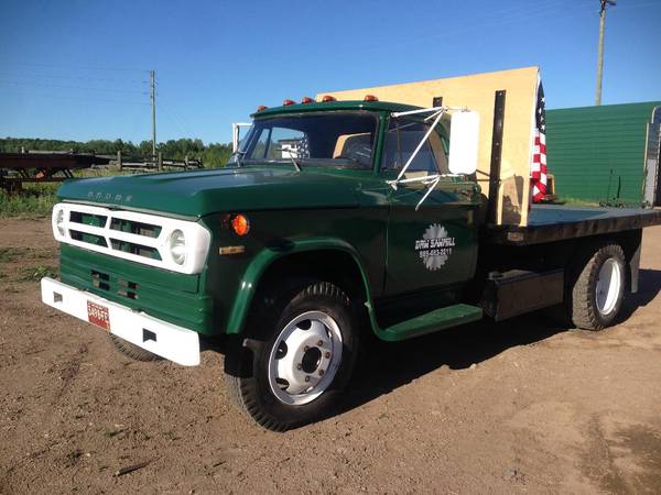

The boss went to CarQuest and chose a color and we sprayed. unfourtunatly it was hotter than the hinges of hell in the shop and they gave us mid temp reducer, and my Mopar loving coworker hadn`t sprayed anything in a while, so the finish didn`t lay out that great. But he shines and looks good.

The day after the parade. You could still smell the fresh paint as it drove down the parade route lol. New cab lights, new LED turn signals on the fenders, new rear taillights, and new mirror glass. And windshield wiper arms. It had`nt had those for as long as he`d owned it lol. Oh. and still the old tires and wheels. It shit out the second clutch master cylinder also lol.

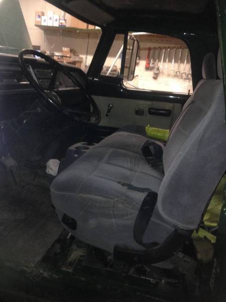

I took over slab hauling duties (that`s right, the old girl still works in the summer) because the boss has enough on his plate. And the seat was atrocious. So I donated a 94 Ford XLT seat. I also pulled out the in cab tank because we did`nt use it due too rust and it has a big saddle tank, and put a bunch of KillMat in it. We also threw a 24" glasspack on (chasing a power issue).
