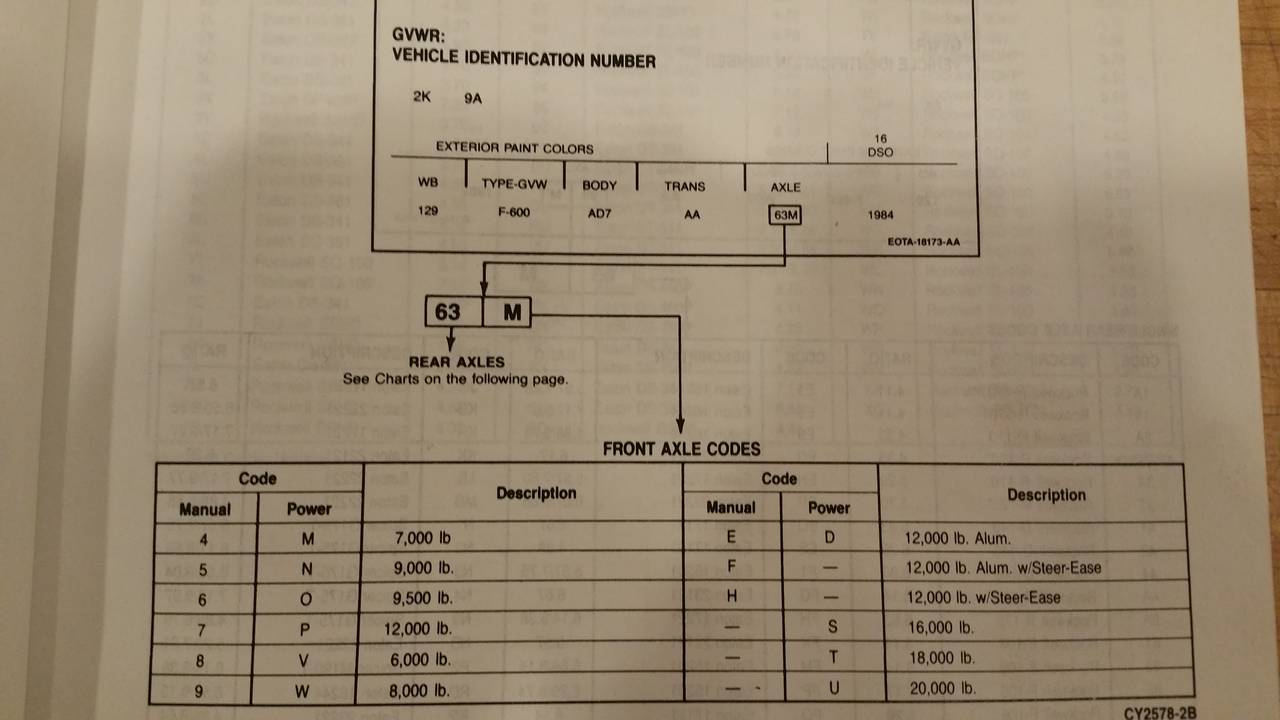

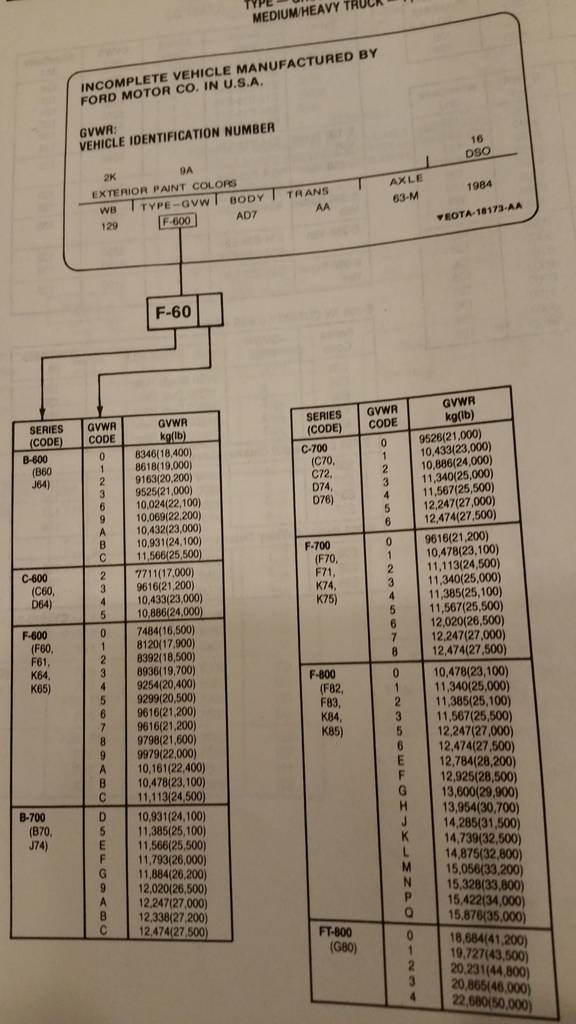

From the VIN tag you uploaded, I have a couple more things for you:
That number starting with the "A" is the build number, my book doesn't breal down the specifics though.
K649 is as noted, 22k# GVW.
The X and the transmisson code doesn't jibe with my book either, I can post that page up tomorrow if you like.
The rear axle is a Rockwell F106 with a 6.14 ratio.
