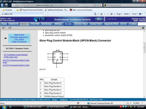

OK, the pics aren't too clear, but here's what I found out:
The separate wires in question are black/yellow and red/yellow.
They seem to all go in a loom down the front of the engine and disappear underneath...
Up top, they go into a loom that connects to the alternator?

in the first picture, the convolute with the duct tape around it looks like the stuff that was added in a previous recall with the icp pigtail. If so, you should be able to open that up to give you more room to repair the wires.
Well, that was my attempt at a temp fix. Since there was no slack in the wiring, I tried to add some. I threw it all in there and taped it up... [further embarrassed]
OK, after way too much stress and time spent on this, its running again. I soldered all the connections after removing those crap crimp connections, reconnected the batteries, and it fired right up! Apparently the crimping job wasn't done well enough.
