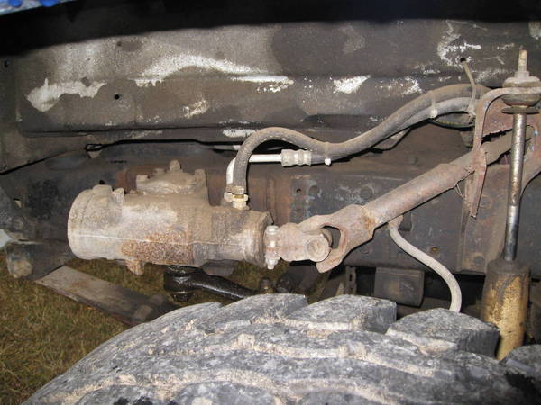

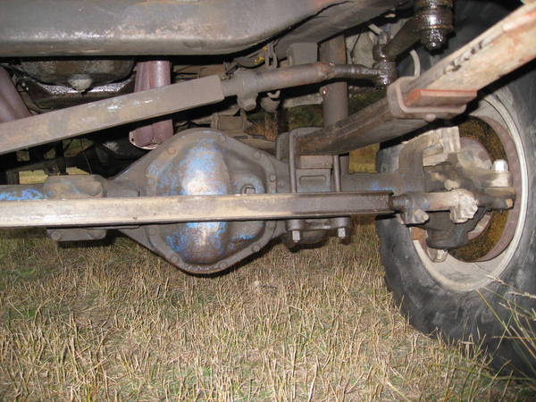

The steering was a nightmare! Not sure what was supposed to be on it but here's some before pics. I suppose it is technically crossover steering but......

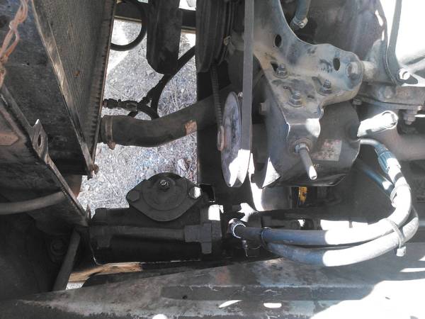

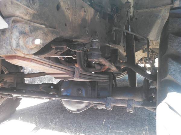

So I wanted steering that is actually supposed to be on these trucks. Or at least a somewhat "stock" set up I can get parts for. I found this set-up recommended on a couple forums besides this one, and when I found the entire setup in the junk yard on someone else's woods truck I had to have it.
I still need to clean up the crossover as I whittled it a bit to fit things in but it's much cleaner, parts can be found, and it was literally 1000% cheaper than what I was about to do.
I still need to replace the butchered shock tower, but it steers like it should for the first time since we brought it home.
