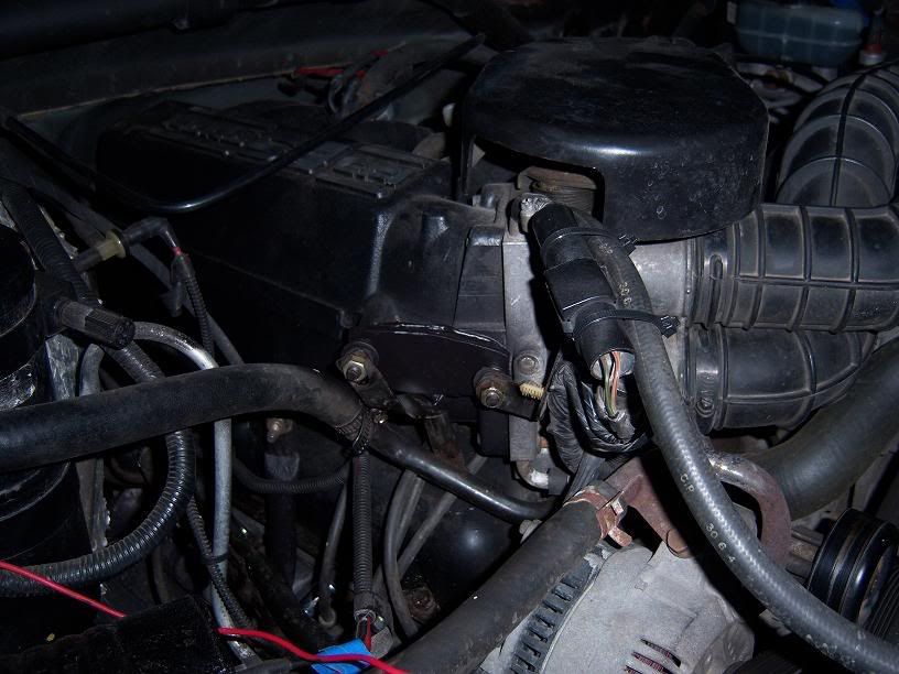

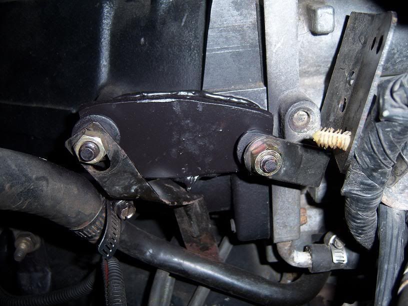

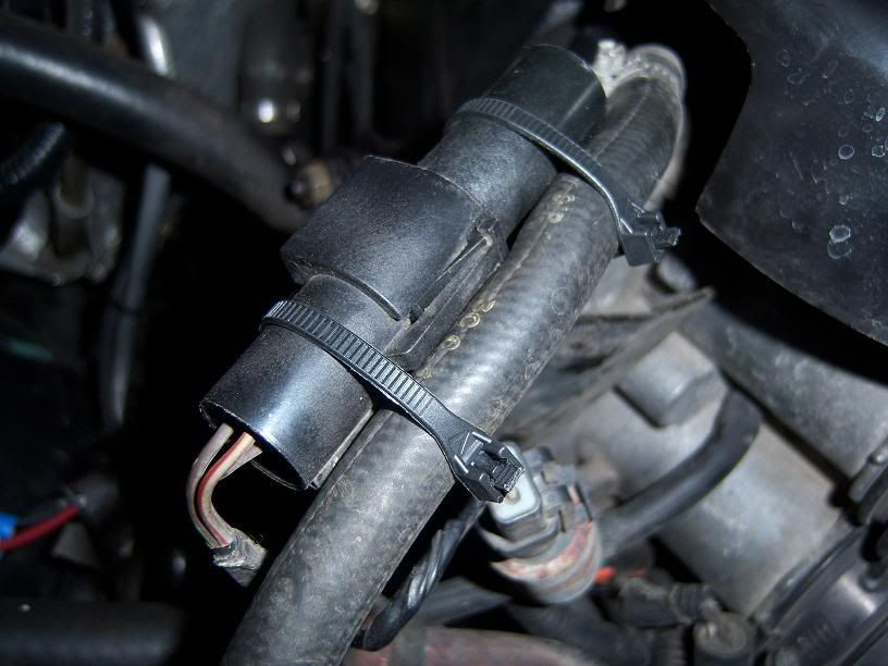

Ok how exactly do i reset it? Yes i used good RTV, and i even used RTV on the end of a bolt and shoved it in the green vacuum line, Of course everything had about 9 hours to dry before i started it back up. Il snap a picture of how everything looks.

Heres what i got goin on.
