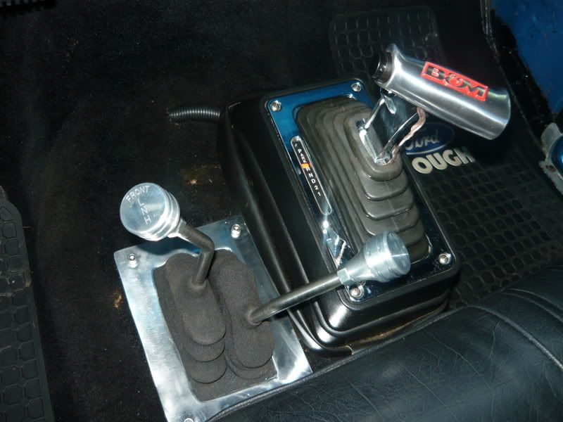

This is what I generally think of when people swap in floor shifters in trucks. The other would work if you build a bit of a pedestal for it for elevation. They don't really say how long the handle is on it, but the Indy is definitely a longer handle.

B&M Megashifter with a bench seat. Yes it can be used as a rachet shifter and has reverse lockout.
