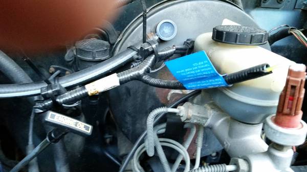

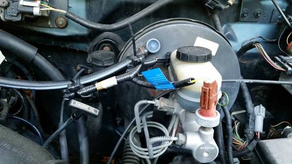

here is what it looks like
it goes from the speed switch on the end of the master, and is zip tied to the vacuum line to the booster
