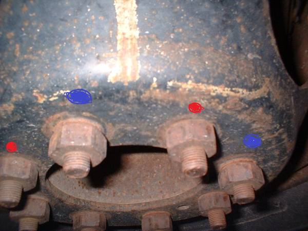

What kind of wheels do you have now? My '76 had the type where the seat for the lug nut altered around the wheel... one seat was recessed like normal, then the next one stuck out. I don't think a newer hubcentric wheel would work. My local tire shop said he could order new 16" wheels with that pattern, although I never got around to ordering them.
I still see semis with split ring wheels.
Red dots = recessed on lugs
Blue dots = the ones that stuck out

Thats the same wheels I have on my 86 F350

Are they split rims or the normal tube type? Mine were the 16" splits.
I never took mine off, but I'm guessing the alternating lug indentions is what centers the wheel on the hub?

Just like those. split ring tube type. I think they are called stud piloted?????

I have an 86 F350 with hub piloted wheels This week end I will try moving a couple around to see. I believe on the rear end it will be no prob. but may need the hub adapter from the front to make them run tru up there.

I think the 70's and 80's wheels will work on it.My dad has a 70 F350 and his wheel are like mine.He took off the split rims and put 16's like mine on it with no problems
