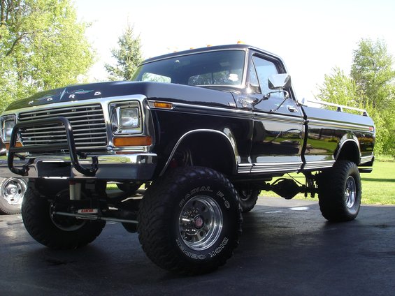

Pulled it out of the garage for the 1st time this year and washed off all the dust that collected on it thru the winter. I also yanked off 12 year old window film that was on the back window. Looks much better now.
885
53
Thanks guys. I think I am going to pull the tube grille back out and put the stock chrome one in again. Sometimes I go thru phases and just want to change the look of the truck.
