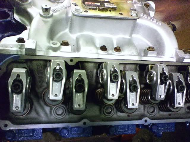

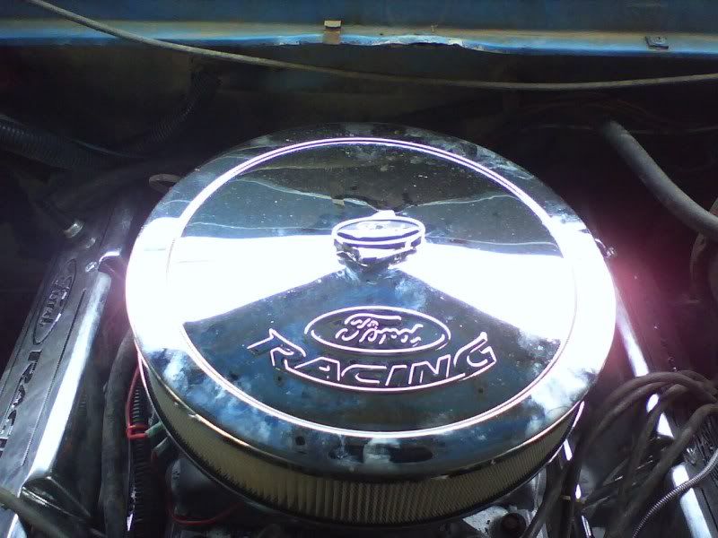

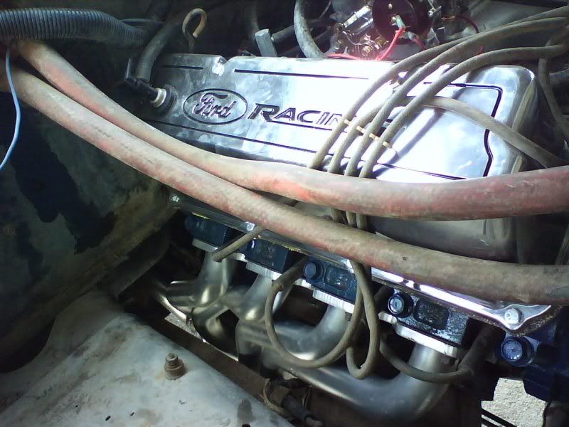

No video but heres a couple pics. I just ordered a HEI dist tonight because its pinging under light accel. Could have just recurved the stock Dist but decided to just go HEI.

410ci, 9.7:1, CHI 2v Heads, Edelbrock Intake and Edelbrock 4 hole 1" Phenolic Spacer, 725 cfm Road Demon, Roller 219/222 @.050 .535 lift 108 lsa, Comp Stainless Roller Rockers, Bee-Hive Valve Springs, Dual Roller Timing Chain, ARP rod bolts, head studs, chrome moly oil pump shaft, MSD Pro Billet, Hedman ceramic coated fenderwell exit headers, Milodon race Pan, HV oil pump and Milodon HV Water Pump.
should have it back again in 2 fridays then im going to take it to the engine dyno and get her broke in and tuned and maybe ill see some HP#'s... 250hp would be nice.

Hey Wyazel...I gotta ask, where did you get those valve covers from? Most the time all I see are for 351W's. I can never seem to find a place that has 351M/400 VC's. And I gotta ask you, what made you decide to go with Hedman Headers?
I had always heard good things about the Headman and i was also concerned about being able to change a starter without header interference. So far I like them alot. I got my VC's thru summit. I didnt spring for the chrome but i am looking for a good cleaner to polish mine with.
