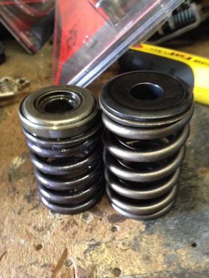

Pulled the rocker arms, push rods spark plugs. Getting ready to swap out valve springs and retainers. I think a 494 lift cam is to much for stock springs and rotators. :headbang:

It is confirmed, 494 lift is to much for stock springs and rotators. I ordered this from Summit racing yesterday at 10:30 and it showed up today around 3. All done and what a difference!!
I went with this K-D spring compressor. The knob was able to be removed and a 5/8 wrench turned it. Glad I went that way because if the knob didn't come off I'd of had to pull the A/C box. I did have to remove the power booster for 1 spring.
And 1 of these to air up the cylinder.
All total it was 183 bucks.
Old to new comparison, quite a bit taller.
