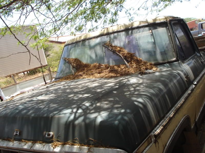

my friend has an 1973-1979 F100 Ranger
and i liked it very much,, !!! always been a fan of those trucks.
what can i do with it??
there was wasps everywhere so i took it and run !! lol Front view
ohh yeah it has a straight axle but its kind of old.. lol or just maybe rusted.. didnt have time to take good pics.. will go back soon and rubble under it.. see what it has and if i can use it... what front axle came with those trucks?

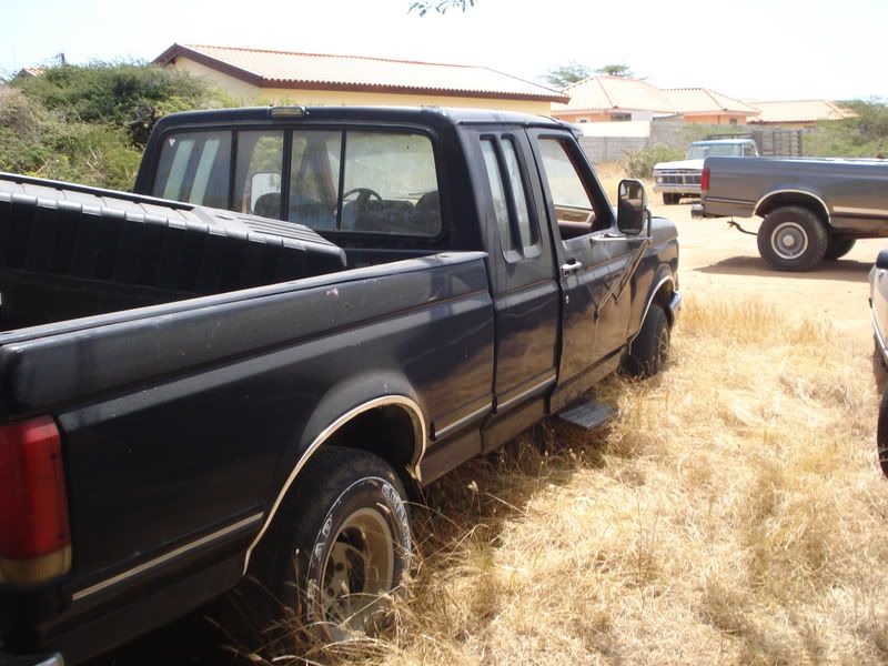

this black 1987-1991 truck there has an 5.8 wich im going to take out and rebuild it and build it.. and when its finished stick into my truck now.. ohh yeah im also going to go with the bullbar
the interior is nice.. 2 bucket seats with a center console.. red
i think you miss understood me bud.. i mean im going to take the engine out of the black f150 and rebuild it mild to stick into my F250 now.. the + side is that the truck wont stop runnning while im building another engine for it ;)
soo basicly what im doing is taking the engine,bullbar,interior out of that black truck
the green truck i dunno... thats allot of work lol.

The front on the older truck should be a Dana 44.
My advice, if you're going to rebuild a 5.8 for your truck is to start with a roller block out of a 93 & up truck. It's an extra 30 or so horsepower.
Keep in mind that the straight 44 out of the truck is probably a 5 lug isn't it? You've got 8 lug wheels on your 3/4 ton.

arg yeah completly forgot about that... nevermind.. ill keep my dana 44 ..
but buddy the engine is very good... we started it it didnt smoke or nothing.. idles pretty good also..

If it's one of the more desirable solid Dana 44's and you want it, then you *might* be able to swap your spindles and/or rotors over and keep the 8 lug pattern. A dana 44 is a dana 44, after all.

got an answere from the owner.. he said make him an offer for the engine and bullbar and if its an e4od tranny he said i can buy it to..
how much should i start? i was thinking of 250$ for engine and bullbar

Don't know about your area, but a junkyard engine goes for about $100 here.
