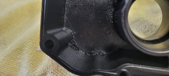

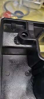

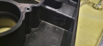

I figured there might be something in the idle circuit of the carb and/or bowl draining probs, so I decided to have a go at rebuilding the carb, a StreetDemon 625. Once I got it apart though, I found these weird bubbles in the body of the bowl. They sound crunchy to the touch, but don't flake apart when I touch them. At least not yet anyway. Obviously I'm not thrilled with these...I have half a mind to sand them off smooth just so they don't disintegrate and make it into the rest of the carb system and just finish the rebuild. But I'm also afraid the prob is just going to continue over time. I know these StreetDemons have sort of an iffy reputation anyway, and it's within my means to just go ahead and buy an Edelbrock 650 instead. But also I'm not thrilled w spending $450 basically because of bubbles.

It looks to me to be a kind of coating that isn't doing well with gas sitting on it.
My thoughts exactly too. After I posted those pics I went ahead and took a razor and scour pad to the bowl and a lot more came off in large flakes. Definitely some sort of black colored coating they coat the bowl with. Presumably they do it for a reason...maybe the composite material they use for the bowl doesn't like gas either? In any case I've pretty much decided to go with a professionally rebuilt Edelbrock AVS2. This demon will go into the trash unless the rebuilder wants it.
