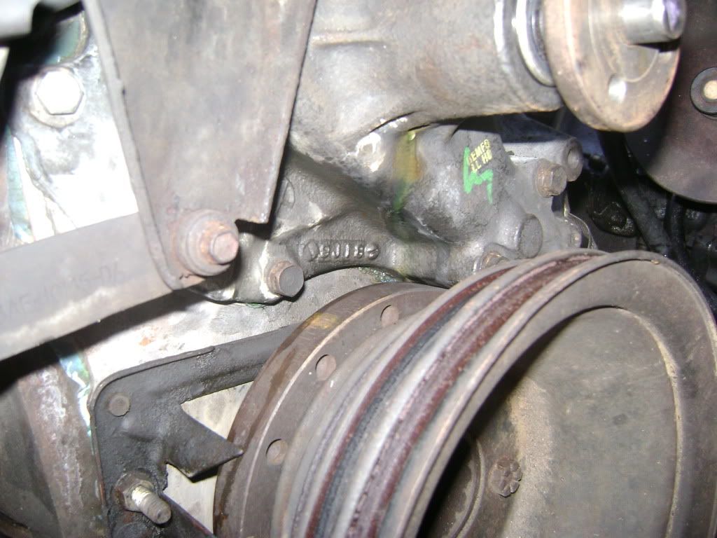

Hey fellas...I found the antifreeze leak. I really don't know what to say about it, I've never seen one leak from this area before. It looks like there is a possibility there's supposed to be a screw or something in this 'hole'. Here are the pics:

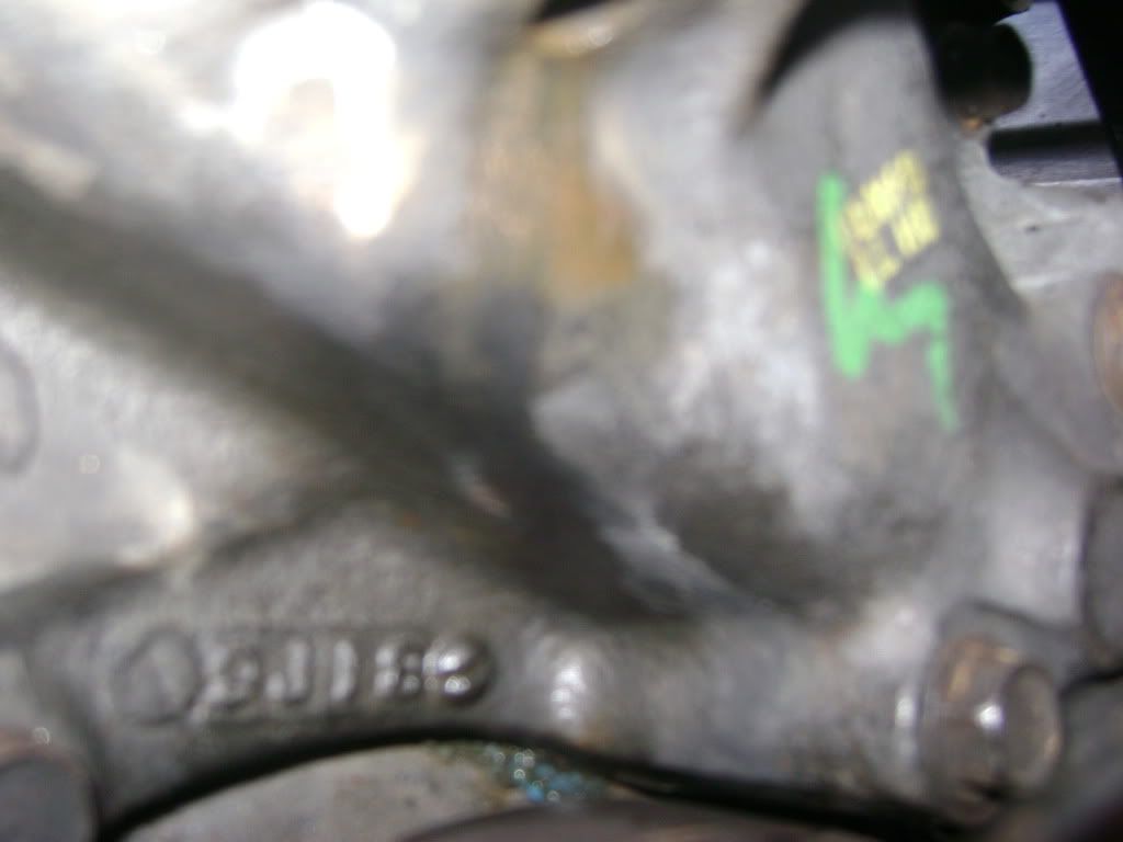

Blurry pic I know but here are witness marks:

Is there something that is supposed to go in that 'hole'? I'm just trying to avoid spending unnecessary cash and I really don't wanna have to pulle the water pump again. So any thoughts are appreciated.

I'm pretty sure that is a weep hole...it will start to leak when the pump seal is going bad...I'm thinking you are going to need a new pump.
Thats a weep hole. First sign of pump going bad will show there
WTF...the pump is 2 months old. Thanks for the info fellas. I've just never seen that before...I've seen them do a bunch of stuff...just apparently not the tell tale sign. Thanks for the info fellas.

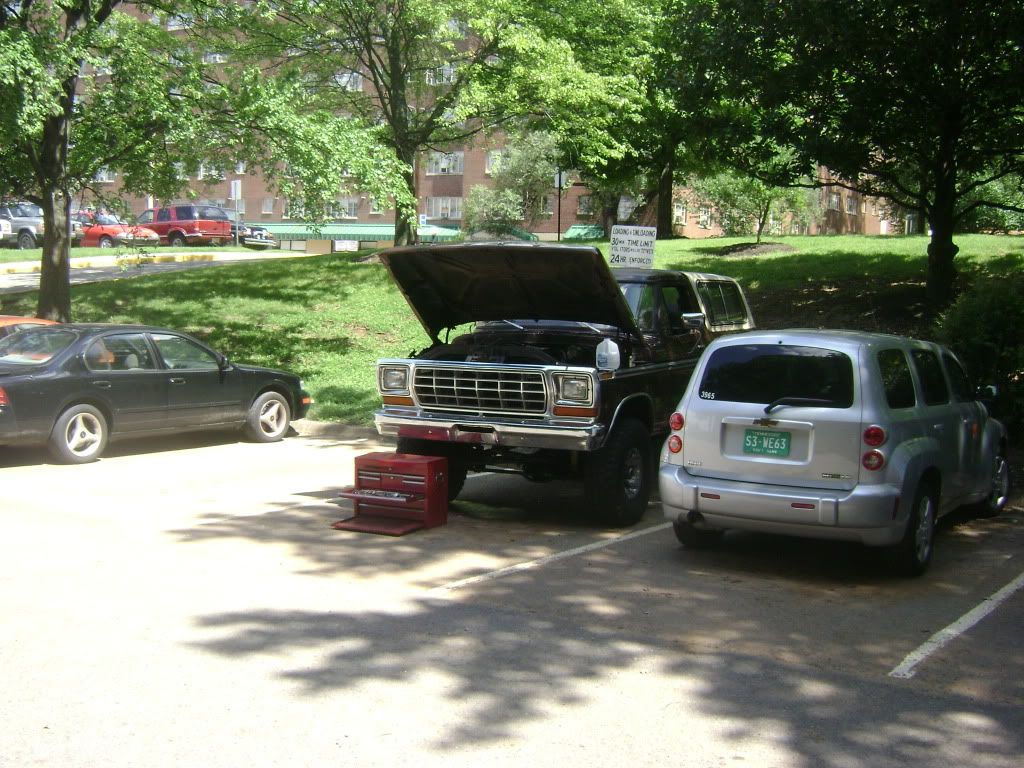

Oh yeah...for chits and giggles...these are my working arrangements:
You live in a dorm?
No...it's an old school apartment. Any apartment within a 5 mile radius of the school was annexed 2 years ago. So I figured why not pick the closest and one of the cheapest.
At least you have all the tools to fix everything judging by that toolbox. And I thought I carried alot of tools in my truck. :shocked:
