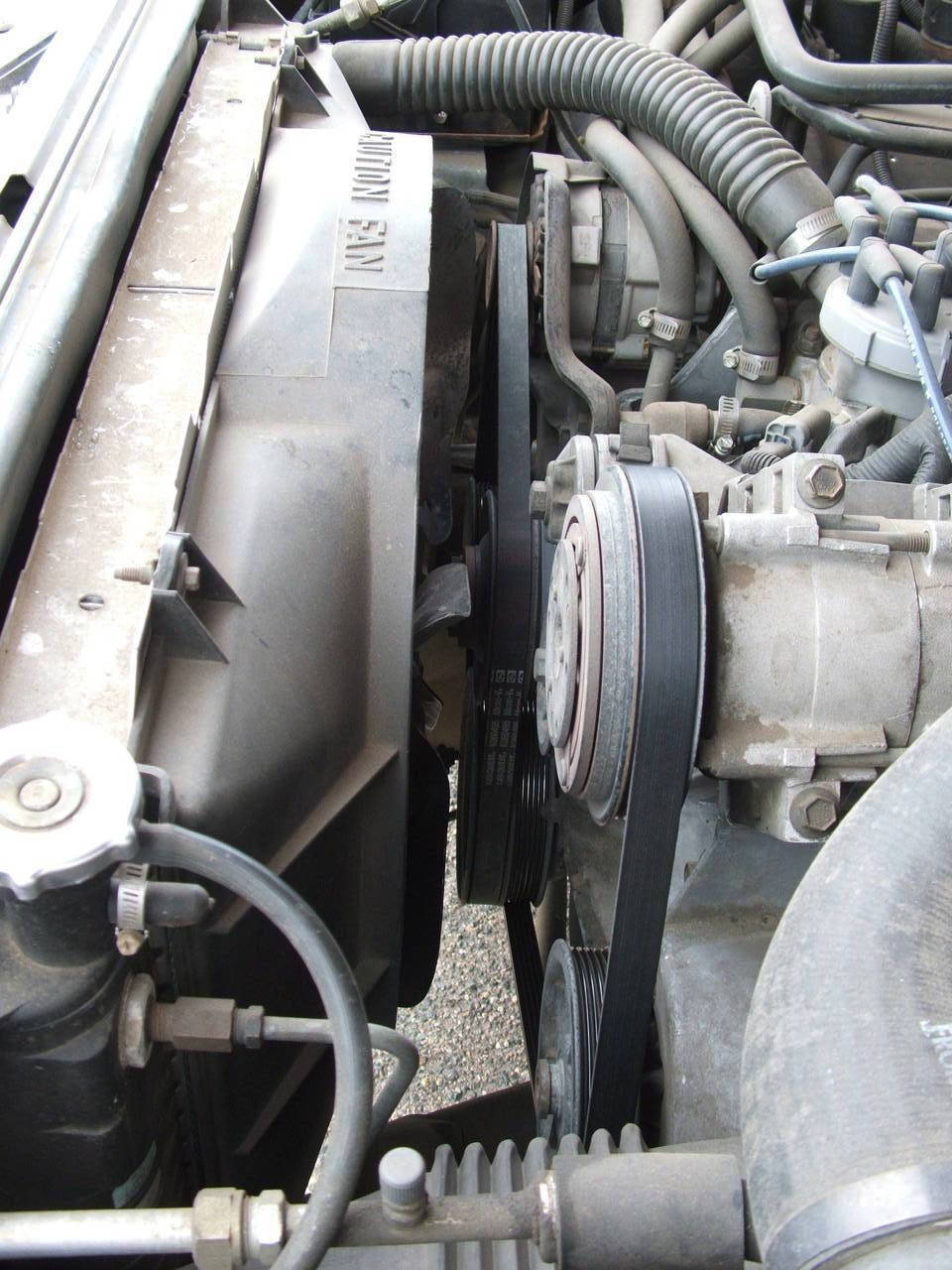

Andy, are you wanting to do a conversion? All the ones I've seen came stock with a 1 or 2 groove V belt pulley for the water pump. Everything else was on a serpentine belt.
On edit, OK, I lied. Below is a picture of my '89 with 460 EFI, and it has 2 serpentine belts, But I can't find(as you already know :D) an application for a serpentine pulley. That is strange, as many of them were made that way...........

This one.........................
Use the crank and water pump pulleys off a 5 liter that doesn't use a tensioner. You might have to make a shim to get them to line up but you don't need a backwards turning water pump. The alternator and power steering pump off the 5 liter will work too but you'll need to make mounts. Mount them both on the drivers side and use the alternator for the tightener.
I got a pulley from 5.8 on it at moment!! but I already got a new water pump so don't want to buy another!!! I gunna go to a local parts store and see if there any that are similar off local cars that maybe fit.
