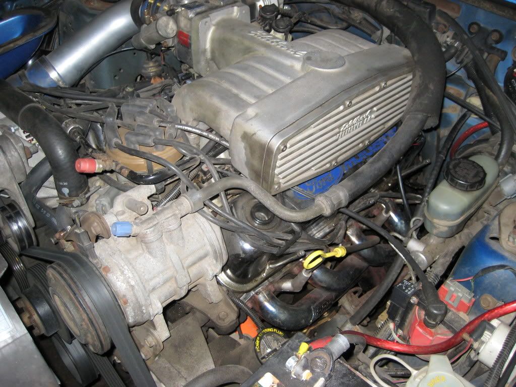

Any 302/351 valve cover will fit. You just have to make sure the holes are in the right spot so you can hook ur pcv and breather lines up. Im using my old stang valve covers. Im a get some chrome ones that say Ford Motorsports at my swap meet for like 30 bucks. There on my stang. If you can see them. Mine are dirty as of right now lol.

I have the stock 302 HO manifold from my stang, but it will not fit a 351W its too wide. The 302 blocks are more narrow then a 351. But if you get a mustang 302 valve cover it will fit under the stock intake, as I have my stock stang ones on my truck.

Yes the stock stang ones do work, other then there is no PVC hole in it. Even if the fill tube is on the other side it still works. Here is a pic of mine, I have the truck valve cover on the passager side untill I make a hole in the stang one for the pcv.
This is the 5.0 Stang stock drivers side one, that I will be using on the passanger side as soon as I drill a hole for the PVC.
This is the Mustangs Passanger side that I have on the drivers side. Fill hole is in the back but works fine. I have a breather on the vent caus I didnt feel like making the stock one to the air box work. They got all white on me but when clean they look good.
