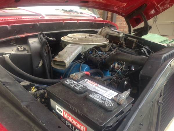

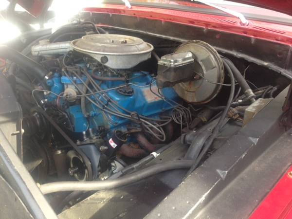

Not that Purdy underneath and in the bay:
It has the AC box, and you can almost make out a compressor, but it's in the wrong location and the alternator should be there, right?

I'm not seeing an A/C compressor in the engine bay??????????? Normally if it is factory, which it should be because it has the box in the engine bay, the compressor would be mounted above the power steering pump. And once again, there is no fan shroud.
Yup....it's what I thought! I think Austin's figure is about right after this.

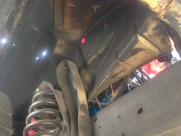

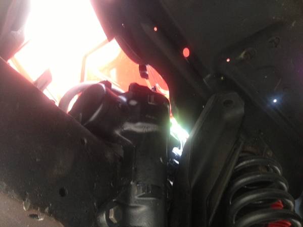

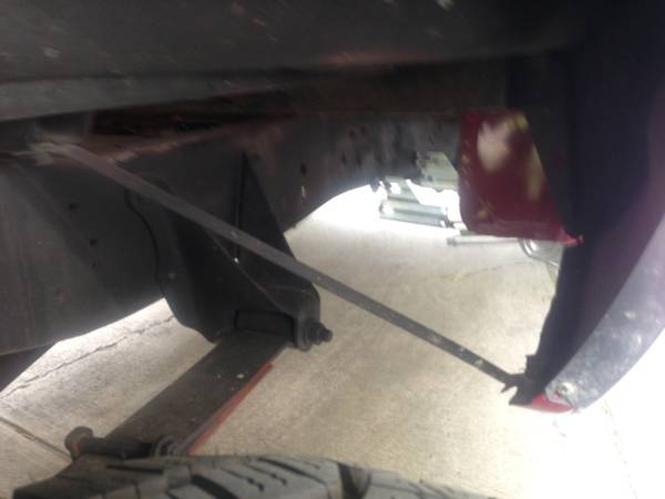

Not there...just the brackets...no shocks
Where's the shock absorbers !!
The handling package had quad shocks. One shock was in front of the axle where you see that unused bracket. The other/primary shock was behind the axle. If the truck didn't originally have the handling package option, that unused bracket wouldn't be there.
On a second look , I do see red shock boots behind the spring.
