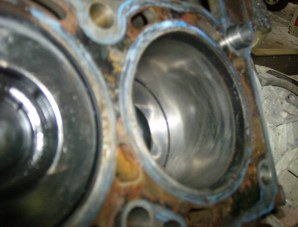

OK... so I am not a mechanic... is the difference that your checking vertically rather than horizontaly? By checking up and down by each valve, you can see where it is "warped" and when checking along the long axis it is not as accurate?
Is that the point your making Vince.... if so... I got it...

Vince is that a fuel crossover line I see on the end of the Head.
Vince, could you see any evidence as to where the exhaust gases were getting into the cooling system? Any chance when you get to that point, you can tell us how many hours are on the engine?

Usually, when you pull off the heads, the gaskets will stick to both the head and the block. The result is, the gasket is damaged. Because of the multi-layer steel construction, its very difficult to visually see defects. I'll see if I can find some "hidden" information.
