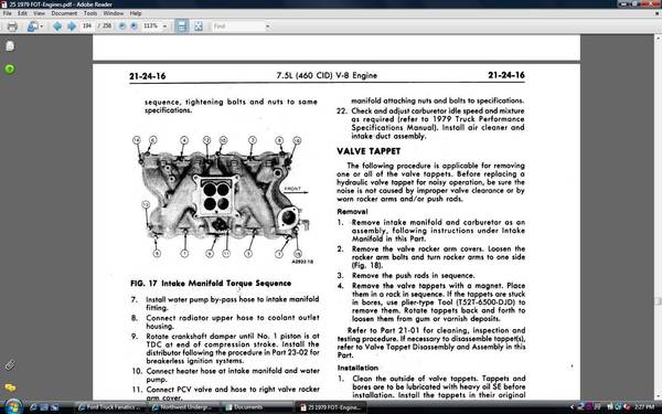

torque specs
Intake to head...22-32
Exhaust to head...28-33

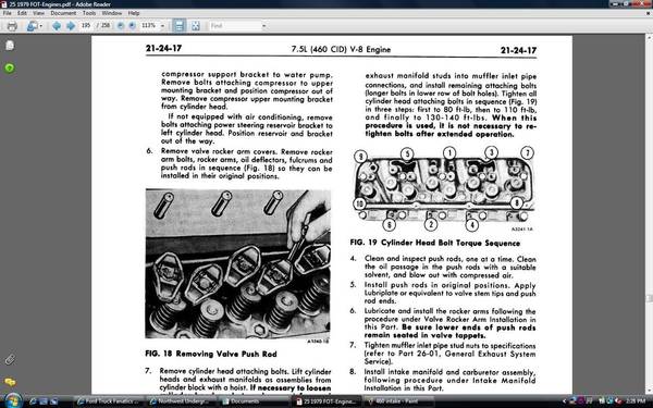

Head to block...first to 80, then 110, final to 130-140
Taken from 1979 service spec book.
I've got the pics for the torque sequence...just having a miserable time figuring out where the hell they are to be able to upload them.
Here ya go....go to my gallery for a bigger pic:
I'm gonna have to spring for a full version of Adobe so I can directly load stuff from the manual....these are from screen shots.
