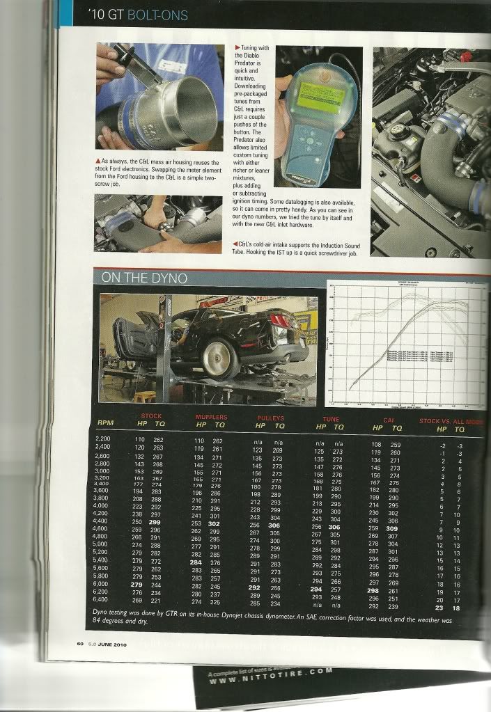

ok. here is almost pure proof that the CAI intake and the TBS is not gonna get near 50+ HP and TQ. it is slightly different same concept.
this is a article out of the 5.0 Mustang Magazine in the June 2010 edition. its bout basic bolt ons to a 2010 Mustang GT. ok. this is the 4.6L V8 though.
but they did a dyno run stock, then with better mufflers, then underdrive pulleys, then with a tune, a CAI intake. and each of these they put the mod on and then demoded it for the next mod to get the full amount of each mod.
and then they did a run with all the mods together. and only gained 23 HP and 18 torque. the CAI itself only gained 19 HP and 10 ft lbs of torque. so unless the TBS gained 30+ i still call bs.

yeah. i agree bout the numbers. when i saw it on the front of the mag i was like dam i gotta pick this up just to see. and i was relativly surprised.
but you also gotta keep in mind its for a 4.6L. but its still the same concept. and hell for all we know hes got a 4.6L.

I wanna know how they got the CAI to produce 19 hp. I'm a little skeptical about the TBS as well...but if his CAI got him 20, more efficiency over a carb might do it. I mean hell, when you go from a stock mani and carb to an aftermarket 4bbl setup, you can easily achieve a 35-45hp gain.
