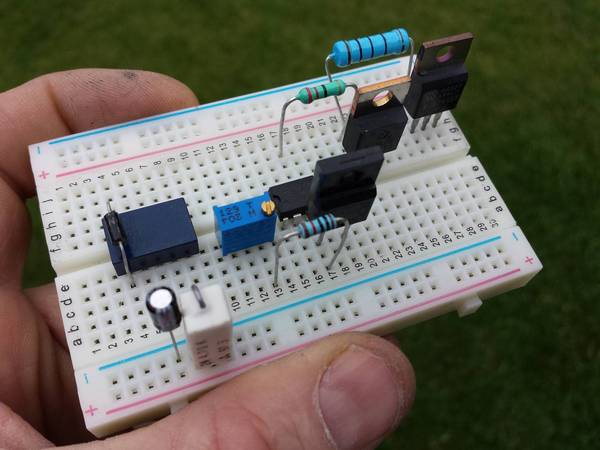

Well, the first part of Concept B proto build is done, locating the components on the breadboard, and doing so in a manner that didn't require ripping it apart and trying over and over 10 times. Haven't done any bread boarding since a Digital Circuit Theory class back at WSU and that was..........31 years ago, so things don't happen at lightning speed. :eek: :( But.....they are happening. :D

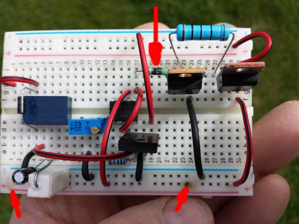

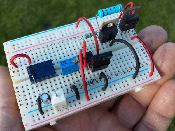

Module completed. Next step is to drink a couple beers, then verify that it's wired correct (I'm 99.99999999% sure it is). After that, preset the POT and then test it in the Ranger. This isn't too bad, it's just five wires.
*In the pic, the transistor in the upper right corner of the pic will see ~ 2Amps. It's expected that a temporary heat sink will be attached to it; nothing more than a scrap of some metal and a screw/nut to hold it in place. Jury is out on the other transistor and Schottky diode.

The smoke from (wrongly and unexpectedly) an overheating 22 ohm resistor has an odor like none other, and the poor little resistor looks like a micro hotdog that was left on the grill too long. And with that said and no other answers as to what is wrong, beer is the final and correct answer for today.

Looks like today will involve component testing to the extent possible and trouble shooting. If there is some good news, it's that before the smoke me determined that about half of the device was functioning (the switching side that controls current to the lights) and half wasn't (side with the capacitor which, as it drains, actually causes the lights to slowly fade). The smoke came after I swapped out a (741) IC, an op amplifier located between the "sides"; this device amplifies the tiny electrical signal from the slowly draining capacitor and feeds the amplified signal to the side with a couple components that regulate and allow the current to the lights to vary.
