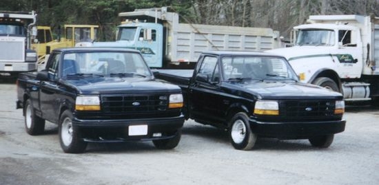

This truck started live in 1997. And was looking like this in 2001.
I had bought a 93 Lighting in 93 from Rice and Holdmen ford. Right out of High School. And got this one in 1997.
So when I was yong and did have the money as good as i can now. It was still save and past NHRA tech to go as fast as it did back in the day.
So I guess ill start at the top With How this truck came about .
This is my stock one And the One that now the race truck.

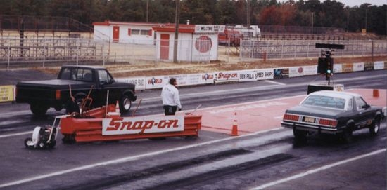

And it didnt take long to start playing with it. and racing in it At Atco In NJ.
And we got it to go in the 14teens. And it was ok. we were using the stock 341 and gt40 heads that came with the truck. And In 1998 and 1999 I went to the WFC1 And 2. And I saw this .

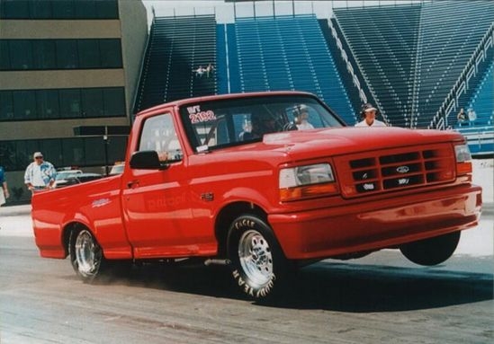

And that was In the NLOC and i was a member. and my good Friend Ralph know Jason Brown. And Jason toke me for a ride. This thing was driven on the street . And it was running low 9sen times.
After that It was to late. I had to build one of these truck to this point.

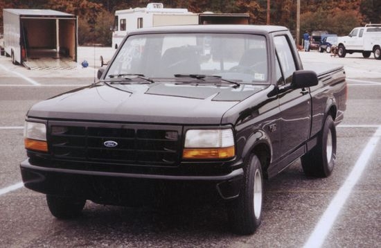

so in late 1999 we were looking like this.
And we got in the 11;50s. Got a PI 3500RPM convertor. And got us a 10:90@121.
