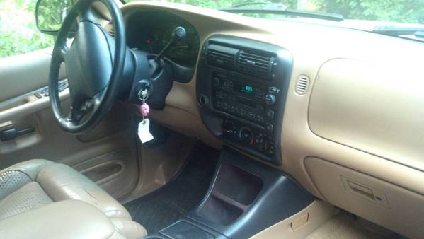

My 'Sploder is a limited 4x2, and the column is as you say.
I put the grease in from the inside with my finger, pushing it in as you would if you were packing a bearing.
I used dielectric grease, because it is waterproof.
This is the only picture I have of the column. I can take more If you need me too
