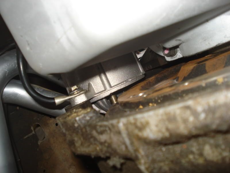

its a 5.0 Explorer engine with a mustang flywheel.. attached to a M5OD Trans..
the starters looks like they are too short and reach the flywheel .. do i need a longer starer or what?? a mustang starter?? or wth??
how does a mustang starter looks like, will it work??

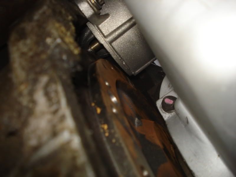

here are some pics of the starter..
its a starter for a smallblockford 5.0 or 4.9 with manual trans

Jurgen, The starter is the same for the 4.9 and 5.0, but the flywheel should be from a 5.0 truck, 50oz imbalance. That might be the problem!!!

Problem is, the mustang flywheel. There is no application for an m5od with a mustang flywheel. I have no clue on this one.
I checked it out already Tony, as I'm working on the same swap!!!
You gotta use the truck flywheel!!!

its the mustang flywheel but the pressure plate did fit on the flywheel.. and it is for an F150 app.
arg noo.. i dont wanna take the engine outttt..
stang starter doesnt work... now how the heck am i going to soppose to start this beast?
the stang starter is longer but dunno,, :S

I think you are gonna have to change the flywheel. Or push start it. :D

yupp gonna change it this week.. lol..
easier to drop the gearbox and change it then take out the engine to change it right??
btw... tony!.. i need a favor.. can your verify that the flywheel from a F150 1989 5.0 ! is bigger than a mustang 5.0 flywheel?? thanks allot bud

I don't know that off hand. I will look into and get back to you, or maybe somebody else here will know off hand.

hey bud i think i need a 167 tooth one.. if there are more teeths the flywheel is bigger right?

Yup, the more teeth the bigger flywheel. I thought they were either 157 or 164.

yupp soo its not 157 its 164 ok... i send summit some letters becuase when you search
1989
Ford
F150
5.0
Manual
Flywheel
every flywheel they have listed for that application is 157.!!

They should be able to help you out. I haven't had any problems with them in the past. It sucks to have to pull the tranny back though.
