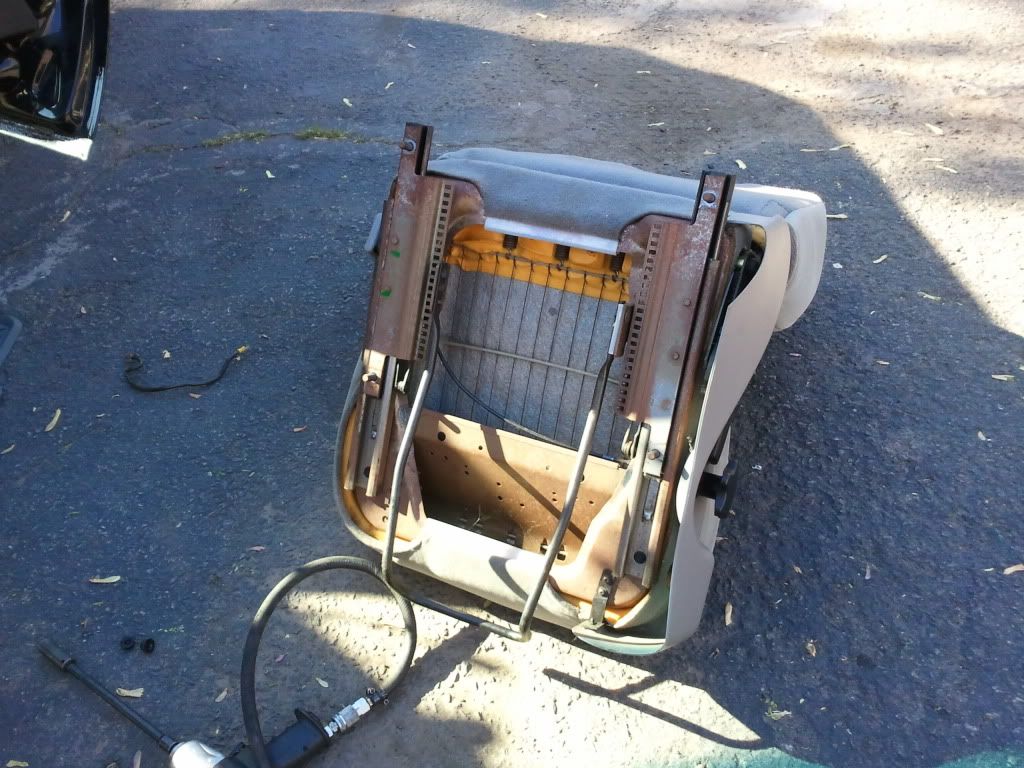

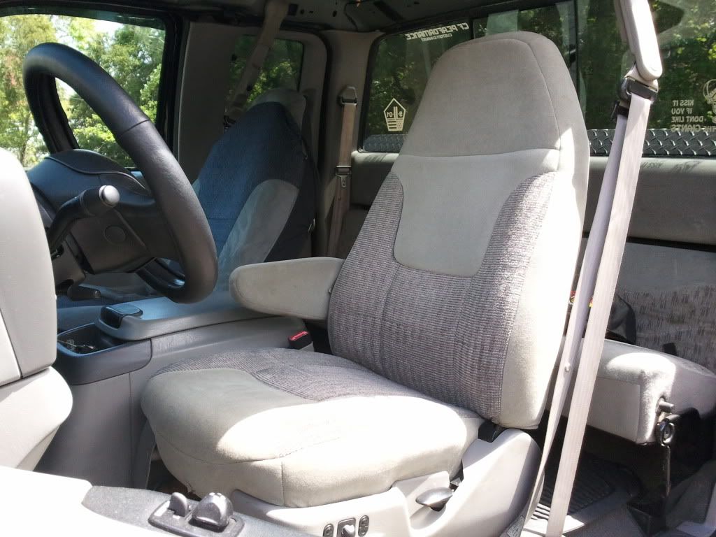

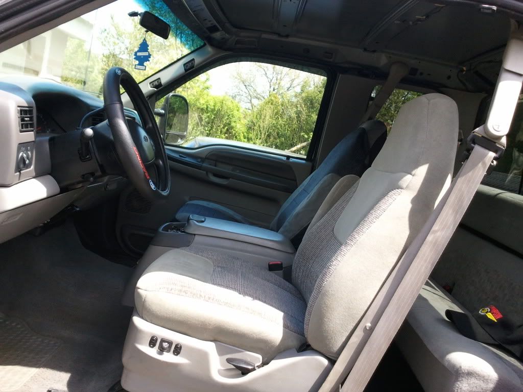

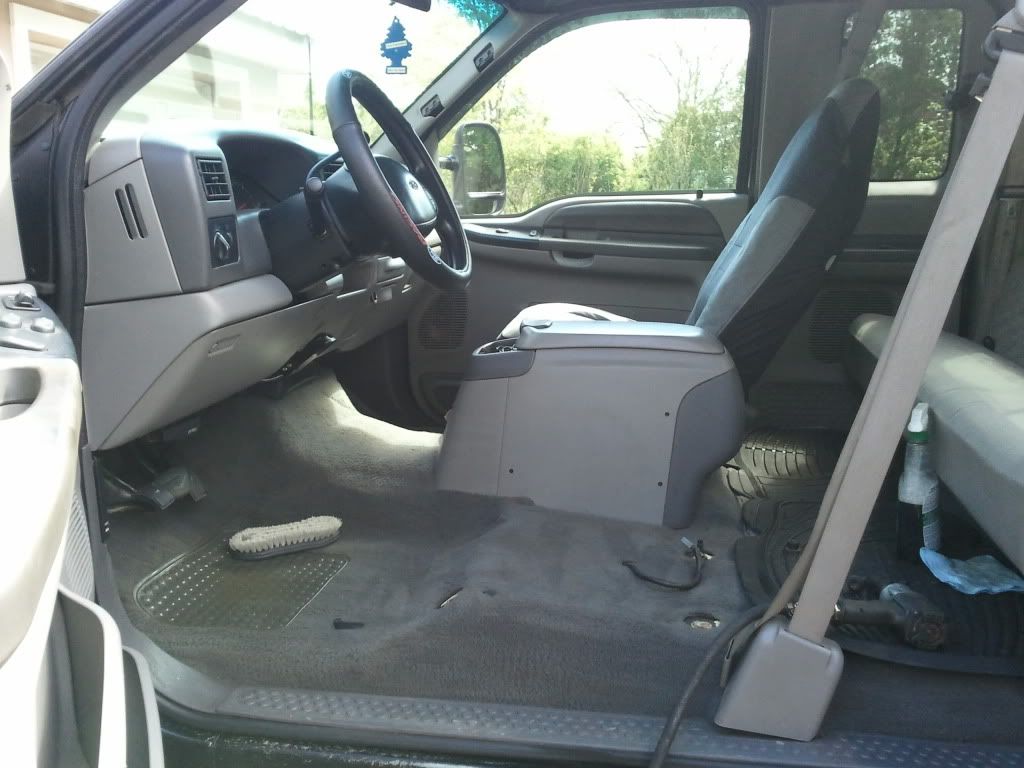

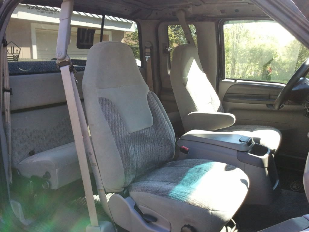

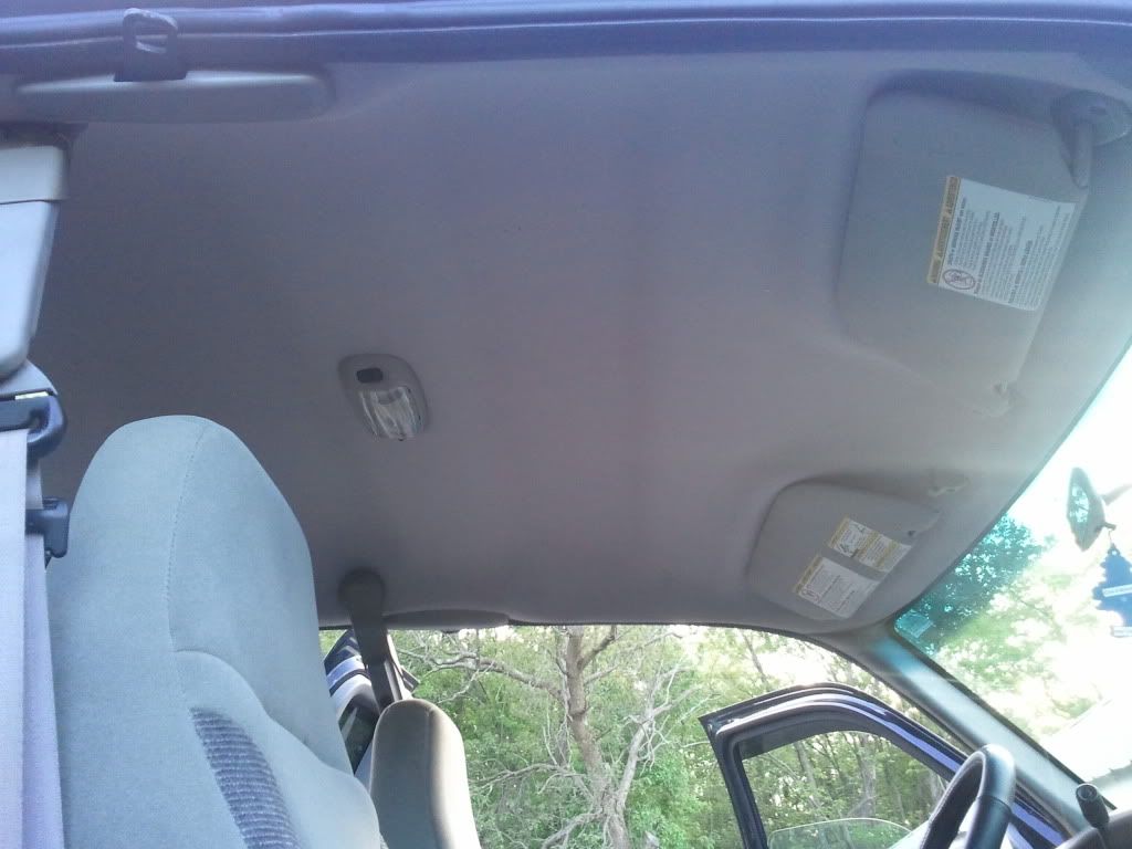

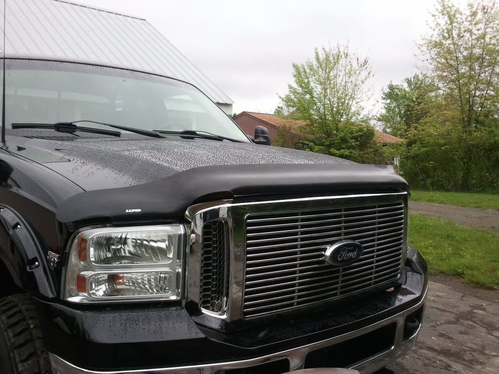

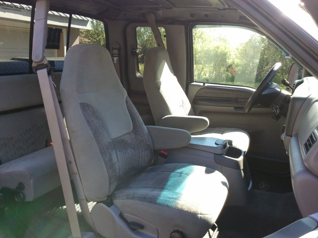

Finally swapped in new(used) seats from a 01 E350 van, passenger was a direct swap unbolt seat from E-Series frame and bolt onto truck frame. The drives was a lot harder caus the E-Series seat was built into the power track. Had to cut all the power section off, weld on mounts onto my SD seat track and then bolt it in. Also the E-Town spring swap meet came and gone, and I got some more things. Got a Bug Deflector to hide where the paint is messed up from the metal bug deflector the other owner had on. Had my buddys shop finally do my head liner. 60 bucks its awesome, interior is done now.

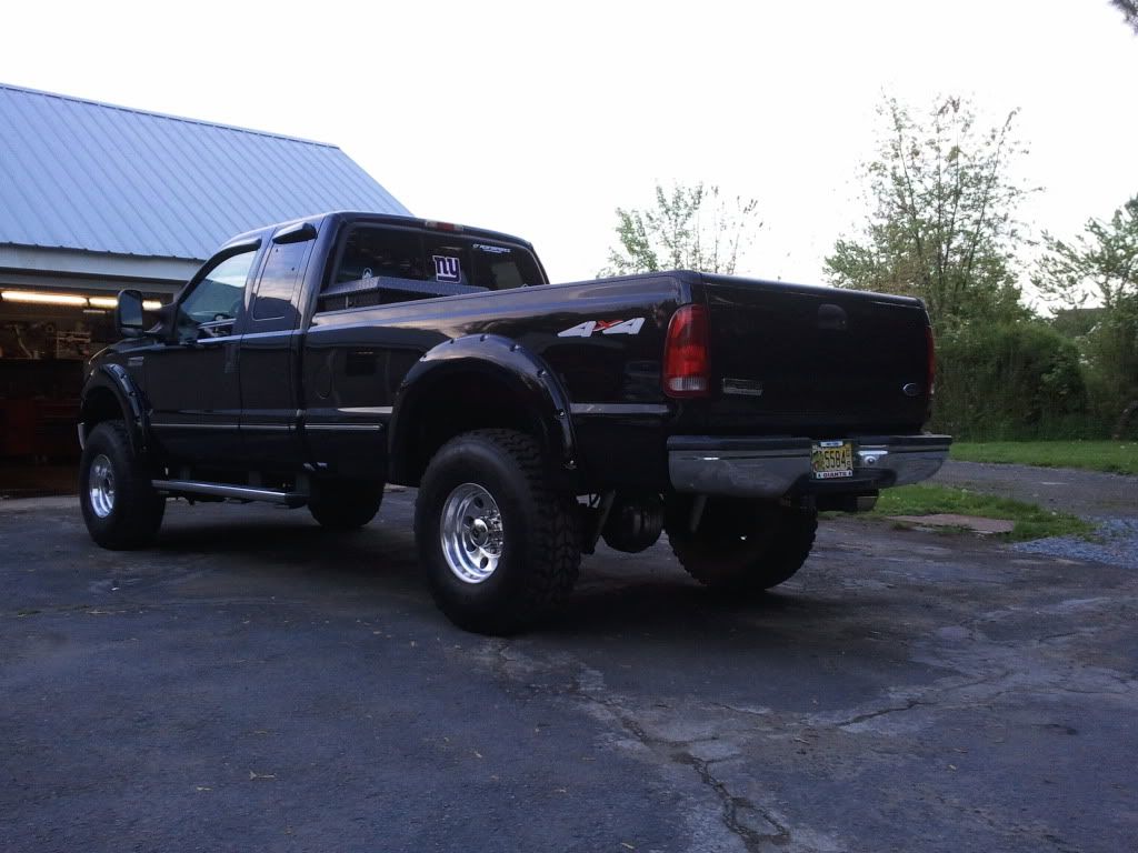

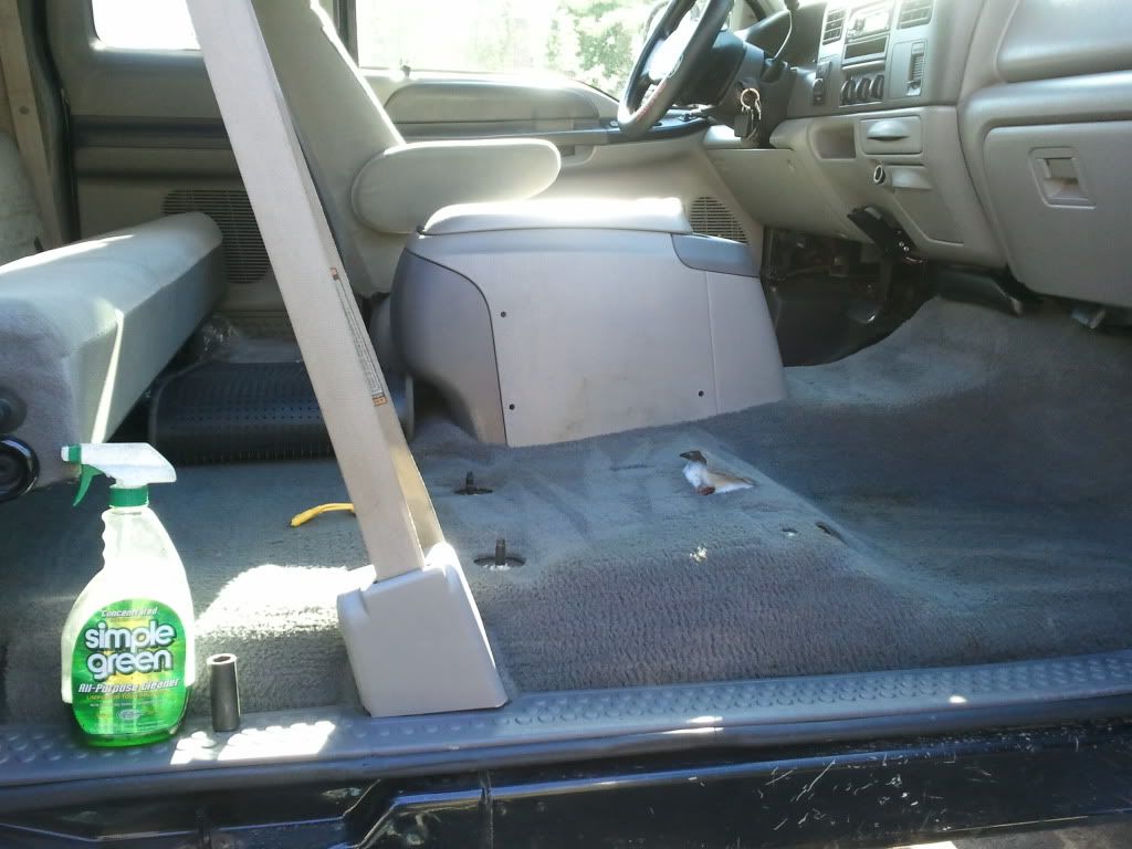

Also spent all week gettin it ready for the swap meet show, Clay bar, compounded, polished, and then waxed it. Undercoated all of the bottom finally, polished out the wheels, and scrubbed the carpets+seats
Way better shape, the drivers was all messed up, cig holes, and the side was gone from sliding in and out. Yea makin the truck nice again.
