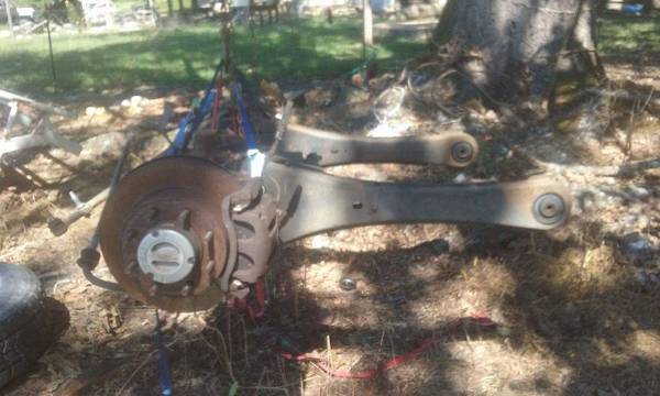

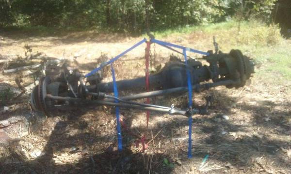

Snagged this 06 60 for $250 for the Bronco...looking for a 2010+ 37spl 10.5, preferably with optional locker. But with a strategic move with LEB, gonna try to make an as user friendly bolt in kit as possible for pre-80 trucks.
^^I think that's a front axle in the photos, Doug.
DOH! Please refer to previous statement. That would certainly explain the steering linkage :headbang: UNLESS LEB is developing 4 wheel steering.(I'm just trying to dig myself out of this hole.)
"I'm not familiar with the newer rear ends."
Haha...no worries. That is the front, I'm ***looking*** for a 10.5 to match. But biggest hurdle will be the RA's...then appropriate coil buckets and hoping for relatively bolt on.
On a second look...I may have misspoke, the drw 80's are definitely 37spl, but I'm looking for a srw 10.5...and I can't find confirmation on those being any more than 35spl.
This is the D60 front from a 2006 350. I think they went to the 10.5 full time in the 2000's, and that's what I'm looking for, something 05 or newer. Pretty sure the e-locker became optional around 2010-2011.
to clarify thats not just a Dana 60... 05+ the f250's and 350s were offered with the Super Dana 60... (f450 - F550 had the Super Dana 60 for the front end in 04) they had slightly beefier (stronger) axle shafts than the earlier regular Dana 60's.. while there are some parts that are interchangeable not everything is.
http://www.fourwheeler.com/how-to/transmission-drivetrain/131-0906-dana-super-60-front-axle/
this article does a good job of explaining some of the differences between the 2...
