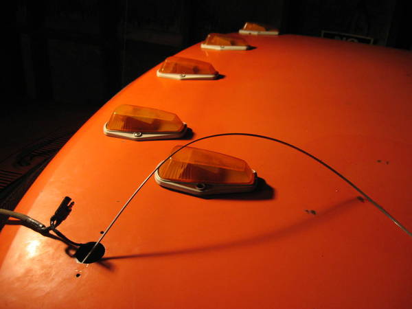

thought I'd throw in this pic for you
lights are on 12" centers
