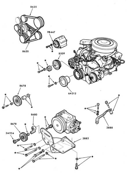

Replaced waterpump need to know what mounts to what holes on the pum on passenger side?
Ok here we go. Got the pics let see with all this brain power at the sites disposal if we can solve the puzzle. Not one of the above charts even shows the correct bracket I have on here. But judge for yourself and jump in anytime, I think I may start a different posting as this one is mixed with great info but is ore emissions related. Gonna put up the pics anyway on both. here you go.

I saw you had pulley belt issues
112
0
Thx Million belts I can figure but the bracket mounting to what and which bolt is my real problem. There just doesn't seem to be any diagrams that map bolt and bracket location for my specific truck. Getting frustrated with it a bit.
I was sure that first belt illustration would help.
I know when converting alternator upper position to lower position you simply turn the bracket and use a shorter spacer.
Which A.C. compressor are you using?
112
0
Stock yorks. Nothing that I can tell has been swapped or changed, from the looks of things. It only has 68K miles so it could very well still be the original pumps, compressors and alt for all I know. Drivers side accessories are all on, and the belts are labeled as you saw. Just can't figure which bracket goes where and it what sequence, I remember I had to remove something to allow access to another bolt and so on. :headbang:
The only other thing I can do is to untarp my 77 460 and photograph it.
Or
To find a better exploded illustration of your set up.
There isn't any procedure instructions in a step by step method.
