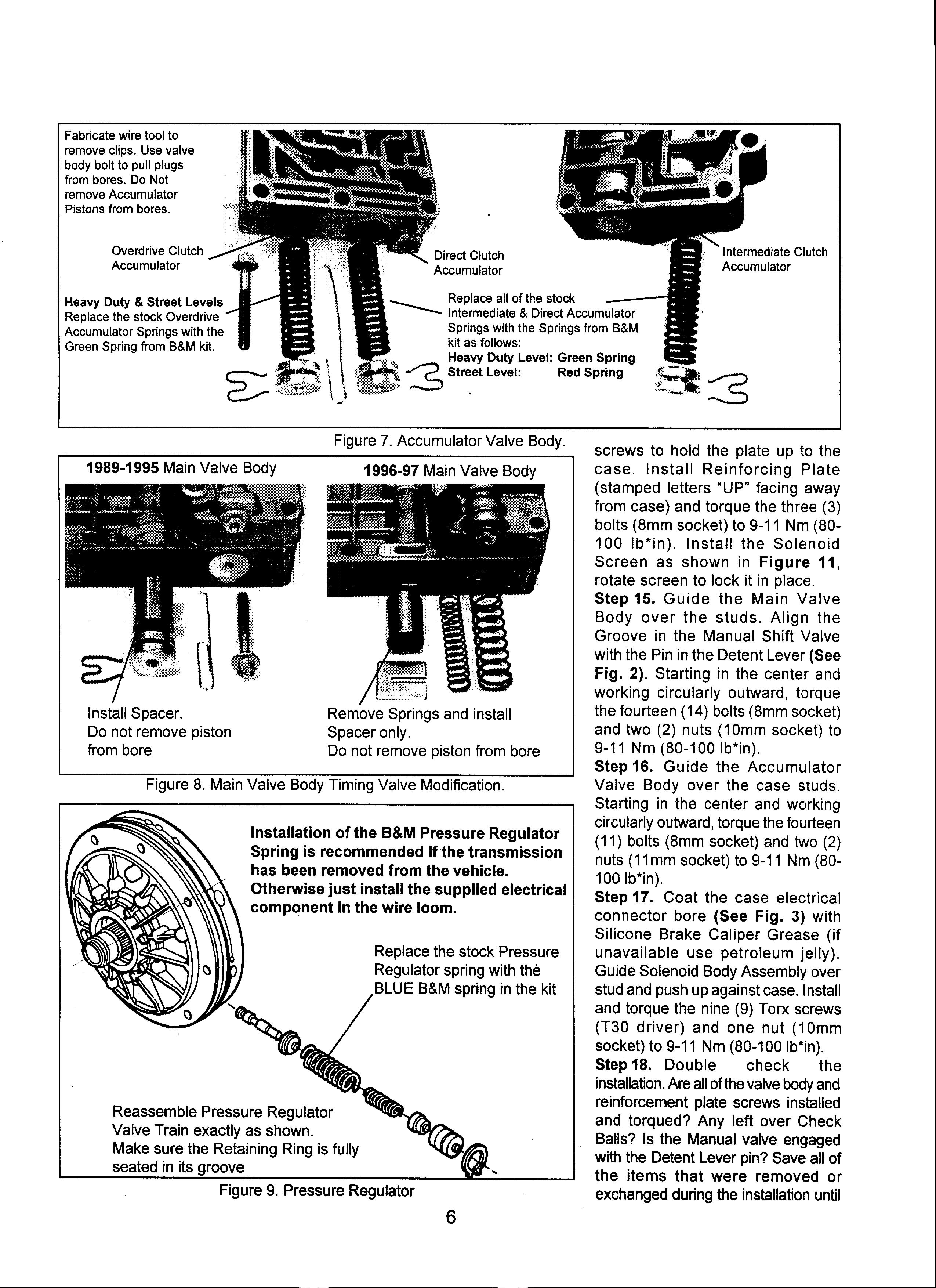

So I mentioned in another thread that my 1-2 shift is wayyy too harsh since I installed the shift kit (seems like its gotten progressively more stiff). The kit involves installing 3 springs and I've heard that the each spring corresponds to a shift (1-2 shift, 2-3 shift, 3-overdrive shift).
So I just got off the phone with B&M tech support and the guy told me that yes indeed each spring corresponds to a shift and that I could find the 1-2 spring and swap it back to stock. But he didn't have the proper information there with him to figure out WHICH spring is the 1-2 shift spring.
Here are the three springs that get replaced with the shift kit:
http://static.summitracing.com/global/images/instructions/bmm-10025(2)6.jpg
Disregard the last one about the pump-- I didn't install that one.
My question is-- does anyone know for sure which spring is my 1-2 spring?
