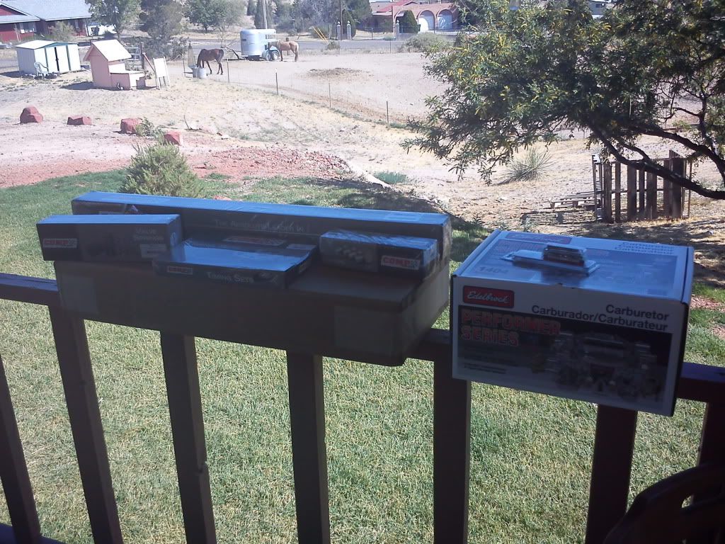

And the fun begins...
alots gone on over the last few months, almost have it buttoned up, pics soon to come. all i need is spark plugs and cam brake in than its a long 3am run to flagstaff after i get 100 miles on it.
