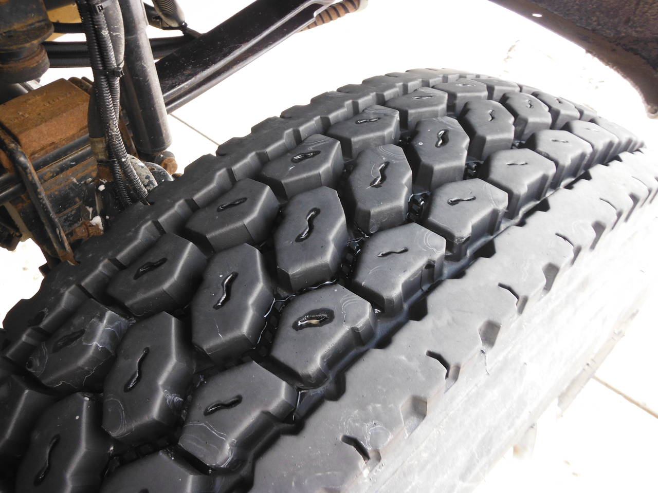

Axle is an MTL-14, planetary reduction and from what I have researched, that kind of tire wear with aggressive tread is prone to that kind of wear.
Balancing was done in both earlier cases with standard lead...gone beanbags this time.
The difference in handling, road noise and turning is like night and day with the closed shoulder tire...time will tell how they hold up.

Seems closed shoulder tires are the way to go to get any decent life out of them on the highway.
I have put nearly 12000 miles on these since changing them last November.
Way better handling, no steering wheel pulling anymore and see for yourself the lack of wear.

I am happy to see this pic, that is the principal difference between the ST tires I took off my hauler and the Duravis R250's I put on it, solid outer rib, my ST's looked alot like your old fronts.
I'm very pleased Ryan, it's too bad I didn't figure it out sooner....on the plus side, when I do get an RV I will be going with this brand of tire...depending of course if the quality goes down the crapper between now and then.
When I picked up the truck today I was talking to the fellow that runs them on his gravel trucks and he told me that a bunch of people have switched to them including a couple of fleets that have 100+ units.

Just for comparison, here is a pick of the Bridgestone Duravis R250 that now reside on the camper. It was between these and the Michelin XPS ribs.
