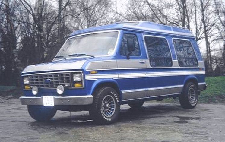

I had a set of wheels onmy old van that I had powder-coated. The local powder-coater only charged me 25 bucks a wheel, and that included the acid dip, neutralizer and wash.
If you found someone with a good-sized ceramic tumbler, it would not only clean but polish them too. If those are the same kind of rims I'm thinking of, the area between the fins is coarse, much too coarse to manually sand. It can be done, but is more like a porting and polishing job.

I just knew there was going to be a reference to a bed.
Did it have port hole windows and a water bed???
:D
No, but I'm sure if you keep looking you can find one. Happy Hunting!
That blue in the wheel was applied first, then it was powdercoated with a clearcoat.
