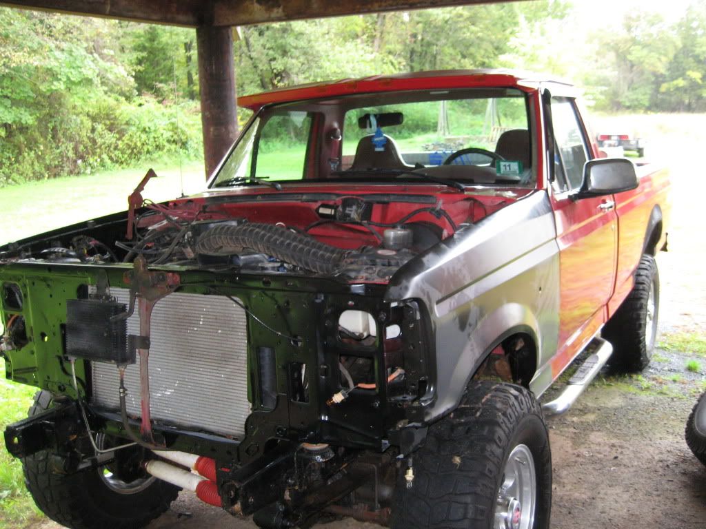

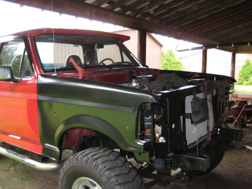

So I finally had some time to work on her. I drove it into the garage with open shorty headers, and then went to work, put on new long tubes, make my Y pipe, made the header back to Y pipe, then made the exhaust system. As usual with me, 1 long tube didnt fit and hit the trans pan again like my old set, so there i went and cut all 4 tubes and hand crafted it so it sits away from the pan, so I can get it down unlike last time, and so the driveshaft doesnt hit then. Then everything went as planned. Exhaust goes 2.5 into a 3" home made Y and then a Thrush Welded muffler out the side. I didnt have a tip so I just cut the pipe to match the bed line for now. That pipe is just tacked in just incase I have to remove it. Here are some pics, also fenderd and rad support are on, and my new wheels and tires are on.

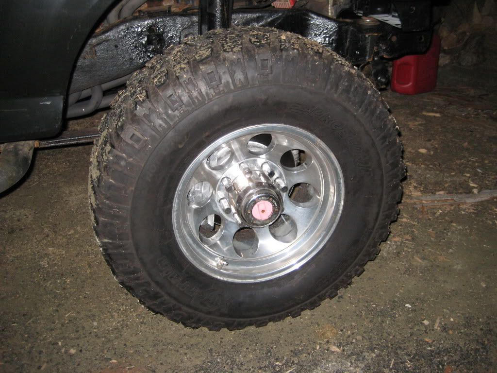

New Wheels and tires/fenders rad support
