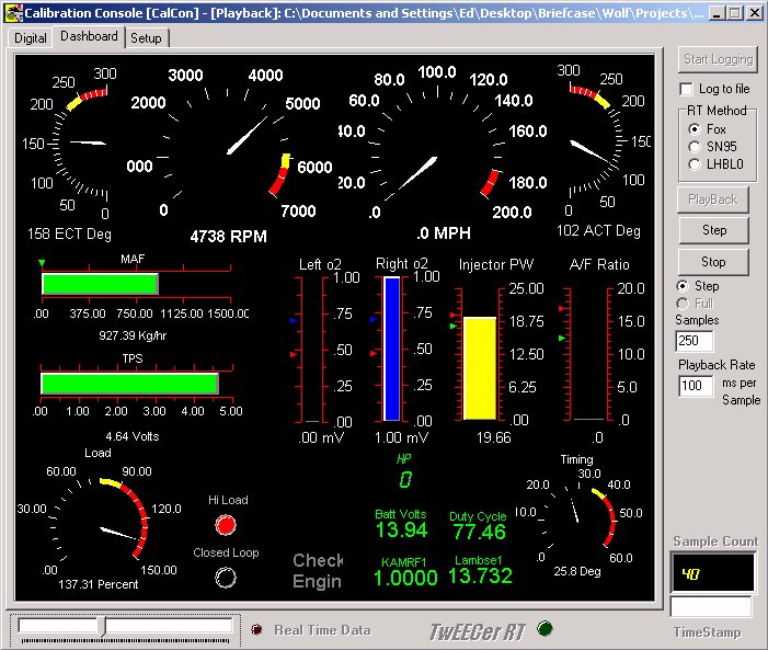

Wowsers! Reading more on the Tweecer site and saw this:
Do you want to fix problems like these?
· Surging at idle
· Bucking at low throttle driving (parking lot)
· Stalling coming to a light or exiting the freeway
· Hard starting (long cranking time)
· Extremely poor gas mileage
Holy crap its like a sign from heaven :rofl: That bucking in parking lots is the MAIN reason I want to reprogram my transmission. It drives me NUTS. Any time I'm in drive, at very low throttle for a couple seconds in 1st gear; then, for example, I'll come up to a stop sign and remove my foot from the pedal to hit the brake; and RIGHT after I remove my foot my transmission had been anticipating a shift into 2nd gear so it tries to shift and then disengages and gives a kick. Wasn't a HUGE deal before the shift kit but now when it happens it JERKS myself and everything/everyone else in the cab real bad. Doesn't seem healthy :(

Skan, please find a fitting picture to include in your post next time :)
It feels incomplete without
Grumble grumble :guns: FINE!
So the price tag on the RT unit (which has real time data logging -- I wouldn't waste my money on the one that doesnt) is pretty hefty... Somethin like $550... The main use for this unit is to tune an engine that has been heavily modified so that it accepts your modifications better (playing with timing tables, air/fuel ratio, MAF readings, throttle position readings, etc). I'd kinda hate to waste $550 on some unit just to clean up my transmission shifting pattern :( I sent a PM to Conanski, hopefully he'll shed a little light on the subject.

Hey.. that looks familiar. And yes, you could use a Tweecer to modify the tranny shift points, though I haven't investigated this with mine because I have no need for it.
