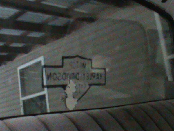

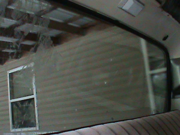

Top pic shows badly faded tint fim,notice the ghost image in the film

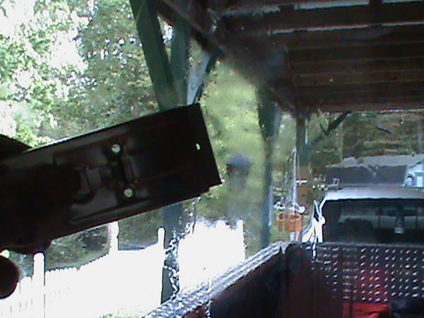

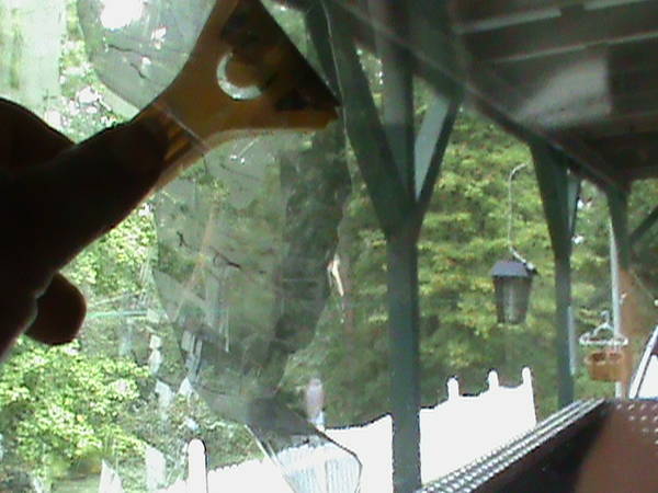

working from left to right i started to peel the film with my blade tool,keeping the tool at an angle so the blade glides across the glass not into it.once i had enough to grab hold of,i began to slowly and steadily peel the film off the glass
Film is removed,but residue remains

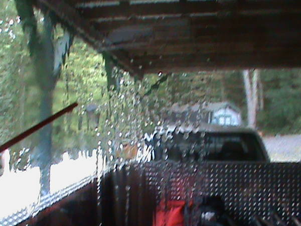

Spraying the residue with WD-40..this stuff works great!!
cleaning off the soaked residue with my blade tool.again keeping the blade angled to glide across the glass.then clean with window cleaner several times to remove all residue.

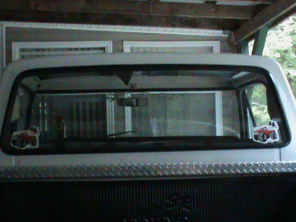

WALA!! No more faded tint! all in all it went pretty well,had about 30 minutes of time invested on the rear glass....:)

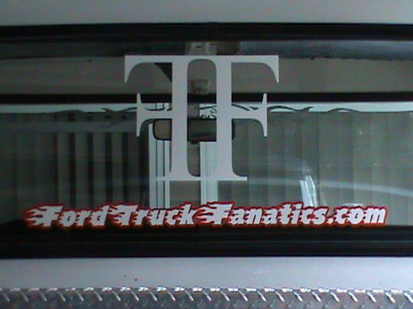

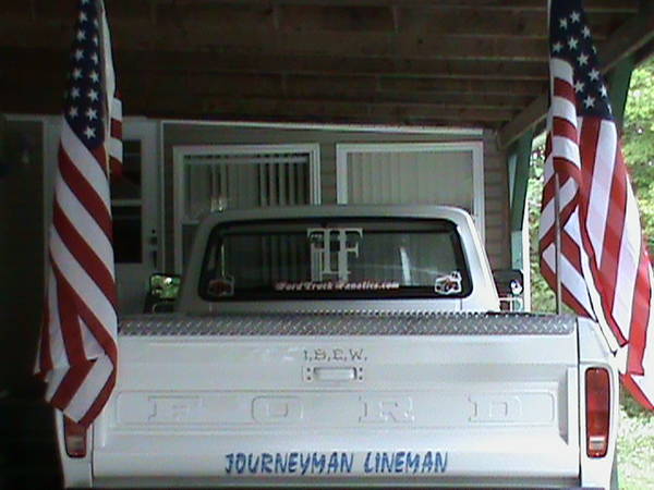

To close out this thread,here are the pics of my freshly applied FTF Decals!!! Well Done Scott!!!! I Love how they look on the truck!!!!
THANKS AGAIN!!!!!
