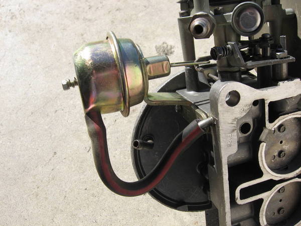

that vacuum line that feeds the choke pull-off is attached to the carb itself,
(that's the 2150 Motorcraft carb on mine)
This picture is a cold start-up, it shows that the choke plate is about 1/4" open when the engine first fires up. The choke plate must open this amount to prevent stalling. There is a cam that has an adjustment for the high idle etc. There is a "V" indentation on the cam that you use as a reference to set the proper high idle when cold. I will get a better picture for you of the old carb.
2,388
The pull off needs a constant source of vacuum Workin usually a port on the rear of the carb will provide this.
Thanks for the picture, Roy. I implied that the vacuum line attached to the carburetor, but I didn't state it outright. Mine goes to the same place yours does.

THat picture helped because thats where i got my vac line hooked to.

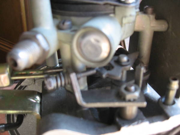

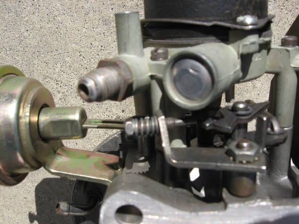

If you could i would like the high idle pic....I think thats my issue because the idle seems to get higher as the engine warms up (just into the normal band) then i blip the throttle and it comes down, but as soon as i give it throttle it high idles again (not as high as it does on "high idle" but higher then normal idle).

the fast idle cam has three steps,
first will be your high idle, usually 1500rpm,
when you tap your gas pedal, it will step down to the second position on the cam, thus lowering the rpm to about 1000 rpm (give or take) when it is fully warmed up, the cam is COMPLETELY disengaged,
the adjustment screw for the cam must not be touching, I will post the picture later today, much easier to see with carb off,
