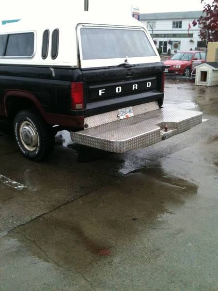

Bumper?
That looks like a cow catcher on a train, lol
