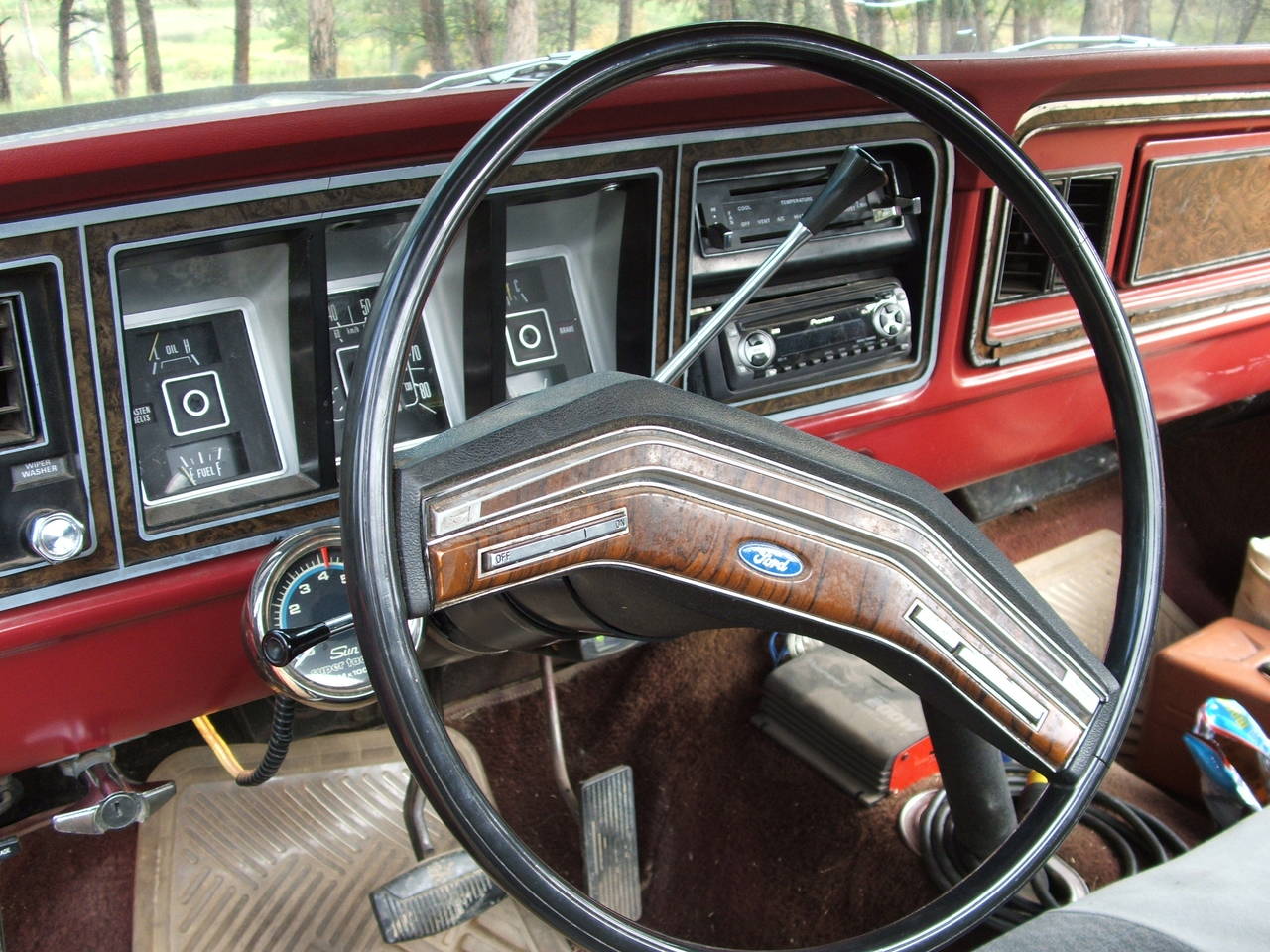

Here is an indirect picture of a pioneer cd player that I put in mine. The hole had already been cut from the previous owner's son, and was a hack job, I have purchased a replacement metal bracket for the heater controls, and a new dash bezel, which I will install AFTER I buy a retro stereo that fits in the same way as the factory stereo.
CD players can be installed by cutting, but they are very hard to make them look professional.
