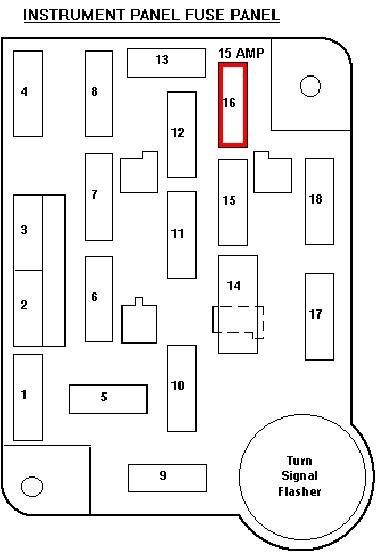

I cant read the codes for some reason the little port that you read the codes through inst receiving any power.

ive got the big reader port under the passenger side dash, Then two little plugs right above the transmission hump. Ive had the codes ran before and just plugging it into the big black port ran them just fine.

What year is your truck?
This is the same circuit that powers your Cigar Lighter (circuit #40, Lt. Blue wire) and is powered by fuse #16 a 15 Amp fuse.
1996 F-150 OBD II Power Fuse.

its a 96
ill go out and check the fuses here in a min.
But awhile back i had a cellphone car charger plugged into my aux power port. And it got bumped one to many times and got loose, and i dont think it works anymore.

LOL theres no fuse in there...
I guess its from when i dropped a penny down in the cigarette lighter. So i removed the fuse while i was trying to get it out and never replaced it with a fuse.
When we bought the truck it didnt come with a cigarette lighter...
