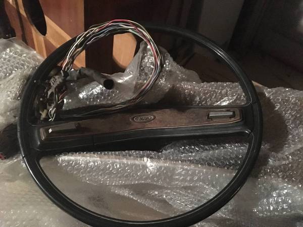

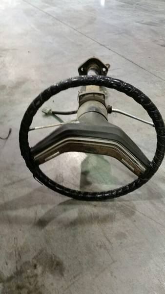

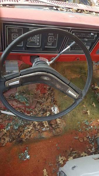

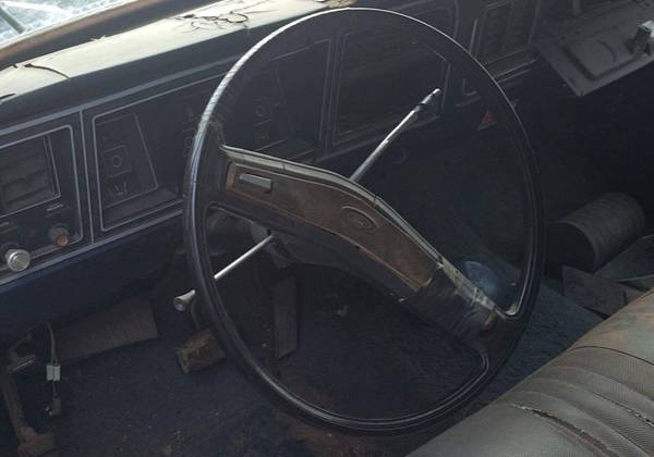

After two years of searching for a pre-78 cruise wheel for retrofitted 78/9 tilt in Red...I gave up hope of finding a pristine wheel. As a matter of fact, have barely found any roached examples. So I've decided to piece a few together. Sounded good until I saw the last one on eBay went for $365 a couple months ago and was pretty beat too, but the guys in my 73-79 groups came through and came up with these four for me. I'm still looking for more, but I'm a happy boy for now. If anyone has any, I currently have at least two dozen 78/9 tilt columns with 78/9 cruise wheels on them up for trade.

At one point in time...been out of stock for at least a year...and when he did have them, the pad/buttons alone were in the $350 range, I've spent less than $100 to get these to my door.

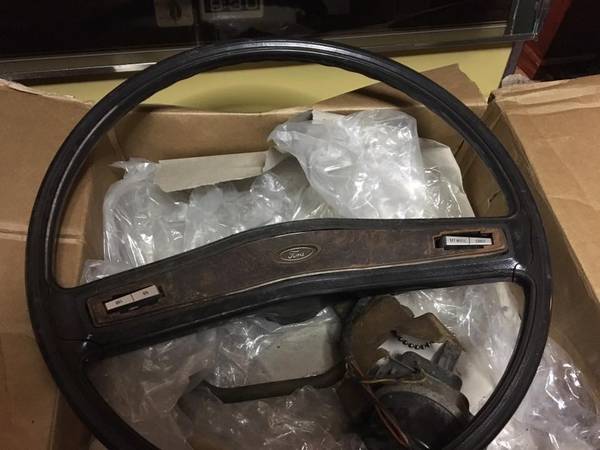

Most my stuff is still boxed up, but I'll be moving it to the new shop over the coming weeks, so I'll see if I have anything useful, but I'm not cheap...haha. I have these two sitting out right now...most are about this shape...
