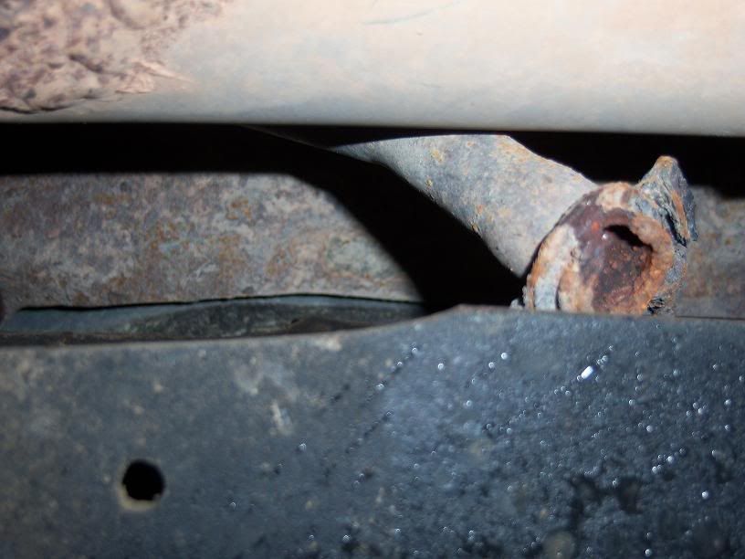

AAAAAAAAAAAAAAAAAAAAAAAAA... OK i was on another forum and they brought this to my attention.... Now I have No cats, and there is that metal tube that goes from the smog pump and into the last cat. Well my tube is not welded in anywhere and its just chilling there... Will this cause pinging and what willl happen if its not welded in there?

Here it is..
Now I have No cats, and there is that metal tube that goes from the smog pump and into the last cat. Well my tube is not welded in anywhere and its just chilling there... Will this cause pinging ?
The metal tube is for delivering air to the cats, connected or disconnect it is downstream of the O2 sensor so it has no effect on the way the motor runs and won't cause your ping problem. Don't you have your EGR blocked off.. or am I thinking of somebody else?
