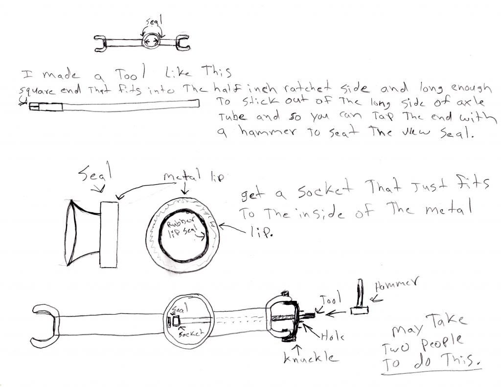

156
1
This picture is a little crude but I hope it helps.:wavey:
156
1
To knock them out use something long and should have a slight pointed curve at the end and they knock out into the diff housing, after they are out I used solvent soaked rags and went through each tube a couple of times to clean all the debris out of them.

Holtz,
That's beautiful. You've probably had situations like this . . . when you're in the dark and then you get the information you need. It's like a lighthouse. I really appreciate you doing all that. I'm guessing I'll be able to see exactly how the other seal is seated, the one on the passenger side and seat mine the same.

and Holtz, seriously . . . thank you again for that drawing.

Okay, I'm almost there. On your drawing you're replacing the seal on the passenger side of the differential. The rod is coming in from the driver's side. If there was a seal already in the driver's side you would have to pass the rod through it, put the seal on in the differential housing and then tap it in place on the other side. Can all this be done with the differential's gears still in there?
If I am replacing the seal on the driver's side do I have to come around from the other side (pulling out the hub's guts on the passenger side) or is there a way to seat driver's side seal from the driver's side?
And anyone reading this would think: 'Why doesn't the fool just take off the differential cover and find out?' And the answer to that is a longer story than we need to hear, but it would help me a lot if I knew before I got in there. Do you remember these details Holtz?
156
1
Yes, you have to remove the carrier out of the diff. housing and make sure the bearing caps are marked and go back on the same way and yes the drivers side gets installed with the tool coming through the passenger side tube.
