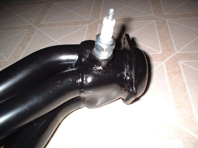

o2 sensor bung
godblessmud
CHECKERS OR WRECKERS
1,596
63
Moscow, ID
Yes! :)
The O2 sensors are stainless steel right? Wrong?
If so, a junk one screwed into your new -bung hole- ring is the way to go?
Seems like there's some stuff that stops stuff from welding together too.
Don't know what it's called but would act like the opposite of flux.
Not needed prob'ly if the old sensor is stainless?
Good one, 5.0! :)
LOL :)
Also glad someone let Mud know we knew what he meant to start with. ;)
Alvin in AZ
I was thinking of idno....a BOLT maybe
espescially since im reusing the o2 sensor
5.0
FTF'er
1,319
In the Middle
The thread most likely is M18x1.5
A bolt may work, otherwise a Champion D21 spark plug shares the same thread, and works good as a "plug" when needed since it has the crush type steel gasket on it. It may work also to keep your bung round as it's heated.
