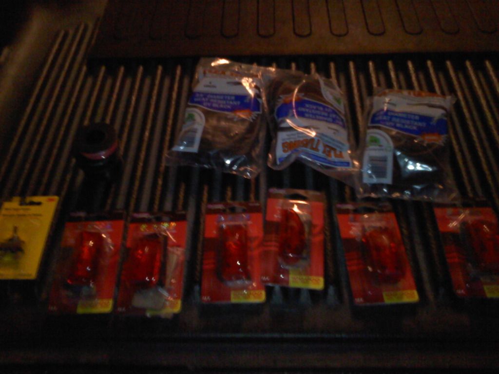

Here we go, probably the last project/modification other than the performance chip for Black Betty here. I will get started tomorrow on these TAILGATE LIGHTS! smilieFordlogo

More deets... Where are all these going?
They are going on the tailgate, 3 on the each side of the chrome handle. Wired into the tailagate and out the factory wiring hole on the passenger side, through the grommet on the underside of the cab, then wired to a toggle switch next to the toggle switch for the running board lights. smiliegitrdone Oh and power will be drawn by a fuse tap.

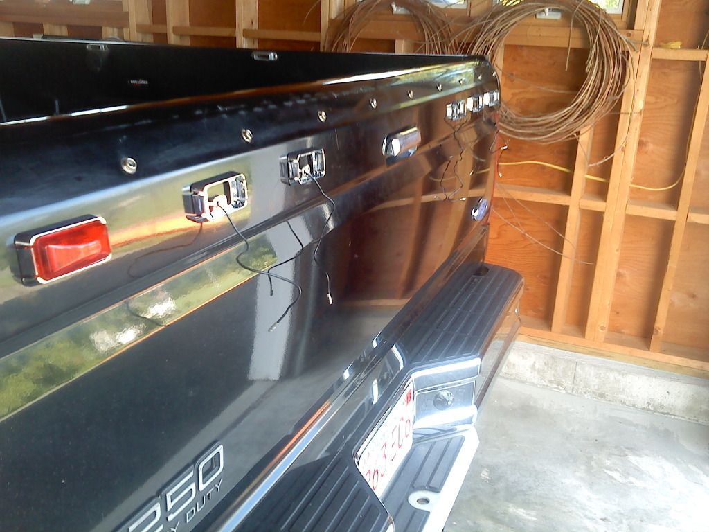

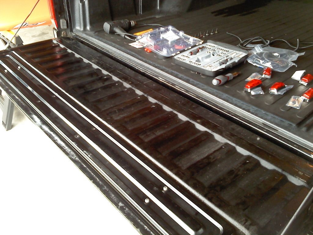

Here's an update, after marking, now I am drilling and took off the back panel.

Ok, I had a problem and just figured it out. I mixed up the Power and Accessory blades on the toggle switch. Man Im dumb haha.

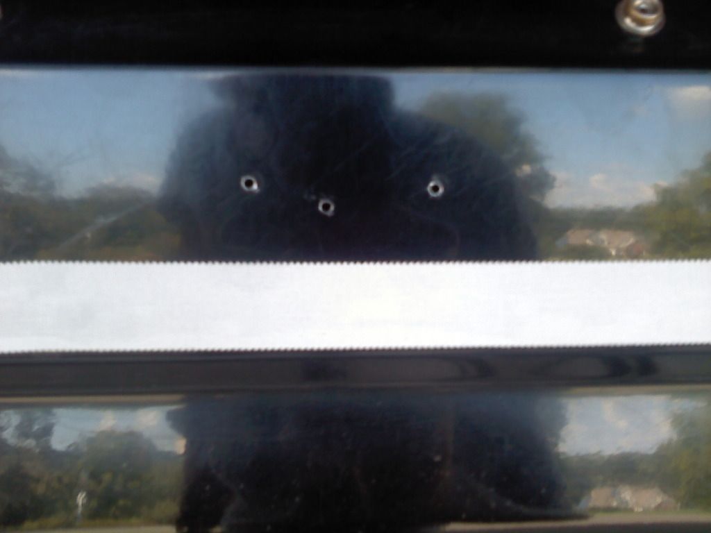

Thanks a bunch Roy! I used medical cloth tape to line and measure everything up. Drilled and removed the tape for a nice linear install smilieFordlogo

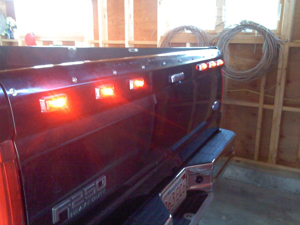

Fixed the problem! Everything is working great now! Stay tuned for night pics coming in a few hours :D

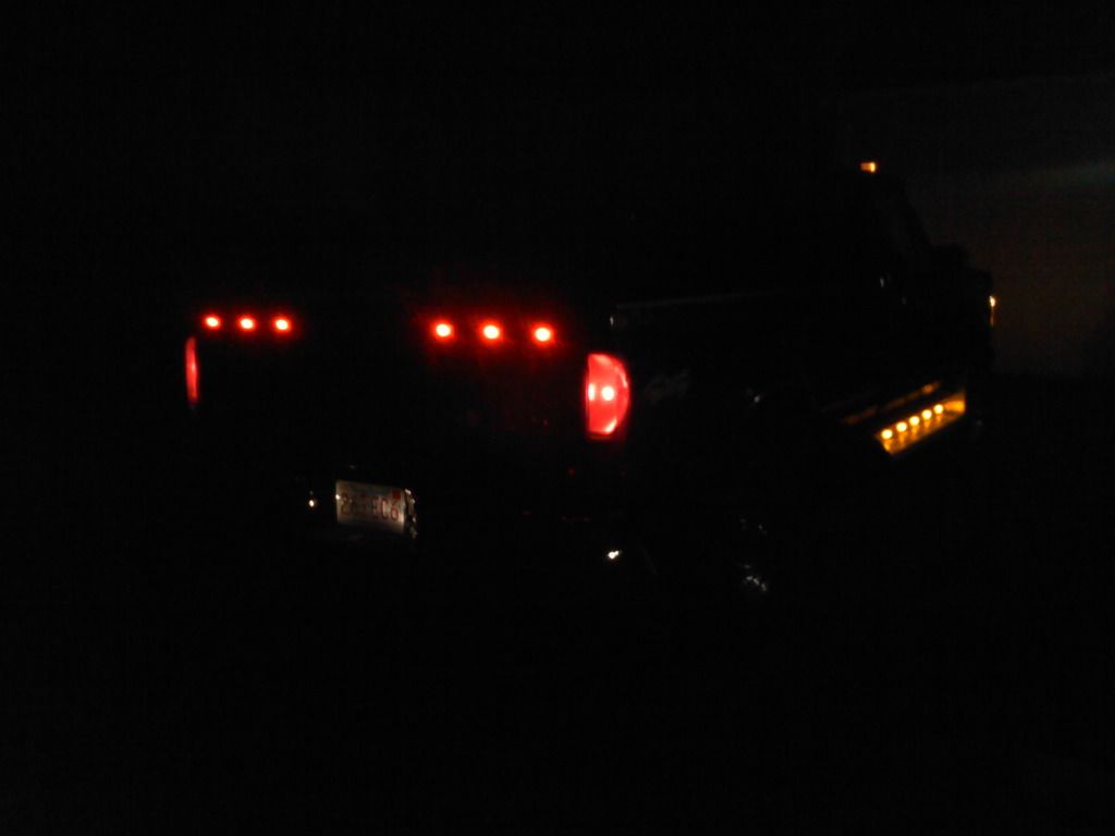

Awesome, can't wait for the night pic's, but they're bright already! You need an air horn now Mike!
Or I can make noises on my PA! :D

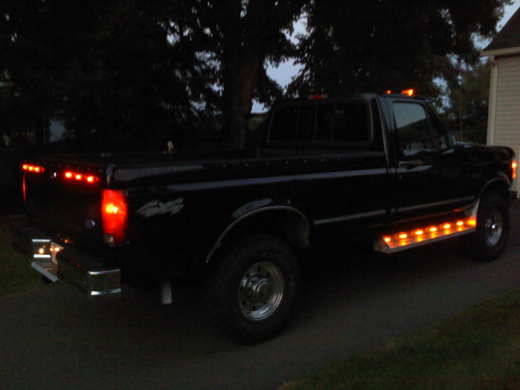

The long awaited final product:

Now all you need are some CAT flaps with some lights on them.:)
